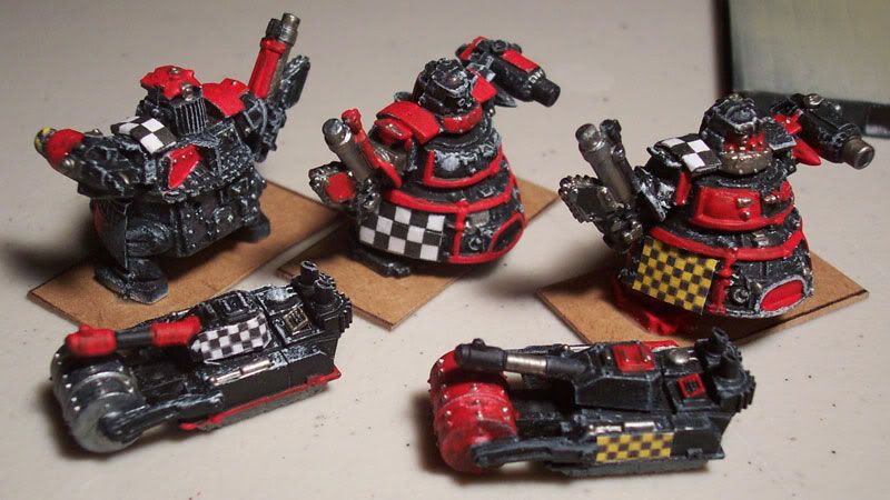

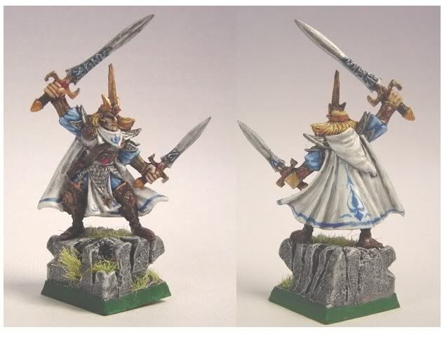

Personal logo javelin98 Supporting Member of TMP01 Jan 2007 11:29 p.m. PST
I started using Apple Barrel and Delta Ceramcoat last year, for the convenience of acrylics without the cost of GW paints. These items were painted using mostly or entirely those two brands:

Javelin 98, which "cheap" craft paint(s) did you use to get those bright red colors on your robots? My craft paint red always come out a bit dull.

Personal logo ColCampbell Supporting Member of TMP02 Jan 2007 7:23 a.m. PST
Richard,
Most of the craft Reds are translucent. You have to undercoat with white to allow the red to "pop out."

Wow, thanks for the replies guys. Seems craft paints has quite a following. Jav, those pics look amazing. Nice work indeed.
