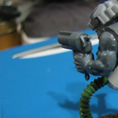

Guitar string will work fine as armoured tenticals, i use it all the time to create armoured power cabling on my Battletech mechs and i have also used its on a few 15mm miniatures.It is tough stuff to cut and does unravel at the ends but only if you are very forceful with it, it's quite easy to shape and i suggest using a old pen or length of rod to wrap it around to create the curves that you want to make…
Below is a example of a mod i done on a Battlemech to convert it into a different variant, i used guitar wire for the armoured cabling.
