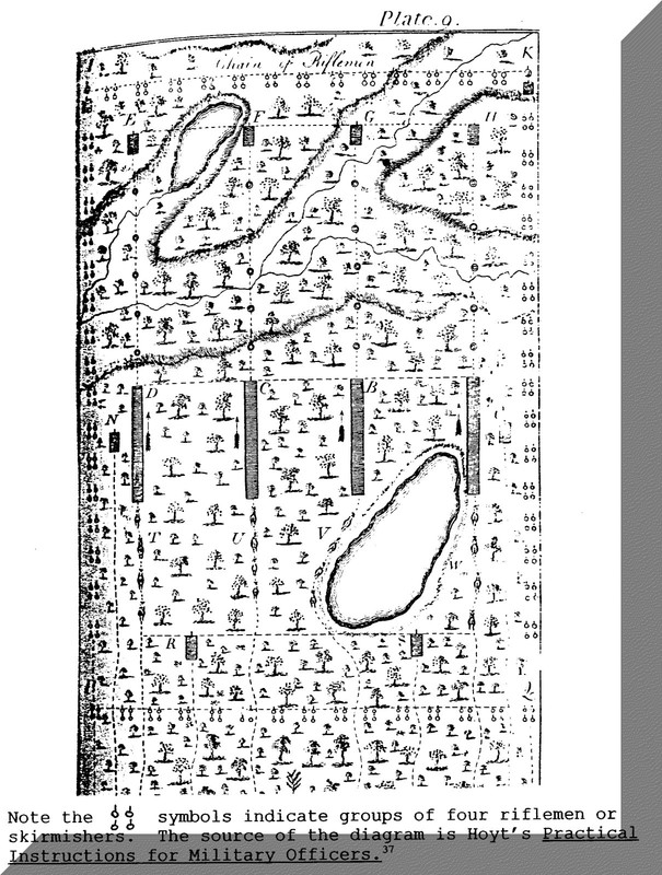

"It also strengthens the logic underlying the physical impossibility of maneuvering and fighting in should-to-shoulder formation in any sort of wooded terrain. There are simply too many trees in the way."
Or as illustrated as early as 1811 by Epaphras Hoyt, in Practical Instructions For Military Officers: Comprehending a Concise System of Military Geometry, Field Fortification and Tactics of Riflemen and Light Infantry.
