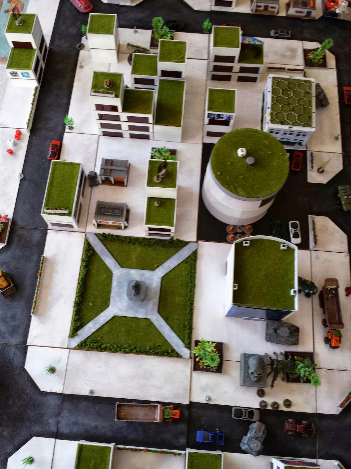

I used a similar principle for my sci fi city some years back. I found that some non-road sections were also useful for pedestrianised areas. These also allowed for some areas of more dense terrain because the road sections can seem very open.
crapidfire.blogspot.com/2014/03/fireteam-andromeda-in-redemption-city.html
