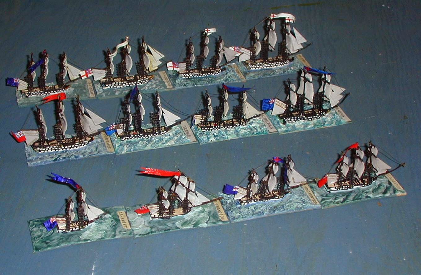

So after playing an age of sail game at a convention recently, I got the urge to do some Napoleonic sail games. I got some rules that I like (Form on Admiral's Wake) but am looking at the ships.
The game I played in at the con just used sails of glory ships, which seem to be 1/1000. This would be easy to do and I could just get some ship packs as I see fit. But I also discovered the ships of GHQ and Langton in my internet searches, which seem to be a little smaller but really pretty.
So I know this is a subjective question, but how hard are the 1/1200 ships to put together, paint, and rig? I'm a decent painter for a wargame standard, but I can't paint eyes on a 28mm figure, but I'm pretty confident with a wash. I can paint gun barrels on an 18mm ACW figure. Are these super fiddley?
I'm thinking specifically of the Langton series as they are often described as a little bulkier / larger than the GHQ ones.
Thanks ahead of time for any advice on ships that you can offer!

Stew art28 Jul 2017 1:00 p.m. PST
thanks again everyone for the advice. I completed my first ship and just thought I would share. I'm also learning how to link photos from blogger, so let's see if this works…
anyway, can see some more pics on the ol' blog at
Special thanks to War Artisan for his guide to rigging using thread stiffened with glue (thanks again sir!).
I am by no means a great modeler or painter, but I think it came out alright, and I now encourage anyone else to start their own AoS project.
-Stew

yes, I have the hook now, there must be two fleets.
-Stew
KniazSuvorov12 Aug 2017 10:51 a.m. PST
Looks good, Stew! If you want to make the sea base look more realistic, get some high-gloss varnish to go over the paint--although if you are trying to match the look of your sea mat, maybe it's not such a good idea.
Stew art28 Aug 2017 9:19 a.m. PST
Sorry Kniaz, I missed this response.
Thanks for the tip and compliment. That is something I want to do, but I thought I would settle on a sea mat first so eventually I might need to repaint the bases.
-Stew
