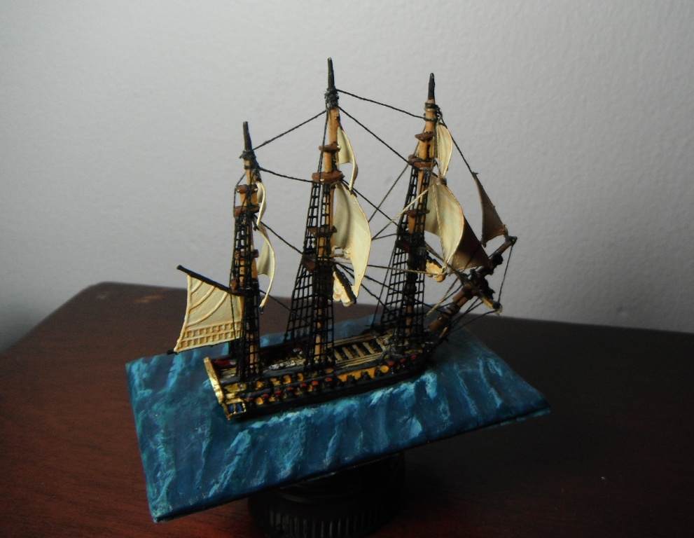

grambo14 May 2013 1:44 a.m. PST
Thanks for the great response, it's given me a lot to think about but it's good to hear from experienced 'riggers'! I have persevered with my first little Frigate from Langton, and made a few errors which I'm sure you guys will point out (I welcome any constructive criticism) including using cotton thread for the running rigging (not yet completed). Something about those foresails does not look right either?
I'll try a few of the ideas mentioned above, horsehair I can get no problem! Beeswax sounds a useful tip as does the stretching and gluing of the cotton thread.
I spent an hour last night reading back through the threads (no pun intended!) here on the board and found it really useful with some amazing pictures.
Here's my effort so far, still working on the running rigging but must confess I find her rather beautiful.
Thanks all,
Lee.
Volunteer Fezian14 May 2013 4:44 p.m. PST
Yes she is beautiful Lee. Now……how about some tips on painting 2MM Napoleonic troops, limbers, cannon, supply wagons, cavalry, etc? Pretty please?

Ben Walton16 May 2013 12:17 p.m. PST
very nicely rigged sir.

devsdoc06 Jun 2013 9:20 a.m. PST
Looking good, Lee.
