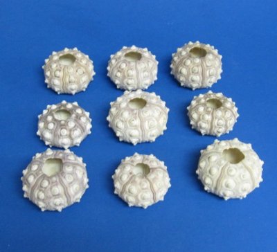

Cacique Caribe26 Jun 2011 6:16 p.m. PST
Crazy idea alert . . .
If there was a way to greatly strengthen a dry urchin shell like this (foam insulation inside and polyurethane varnish on the outside), and then roll it over polymer clay, do you think it could imprint a texture similar to that of the alien secreted walls?
QUESTION:
Do you think it could create they proper negative impression on clay?
auction
Dan

28mmMan26 Jun 2011 6:35 p.m. PST
I didn't see the sea urchin post.

Cacique Caribe26 Jun 2011 6:37 p.m. PST
28mmMan,
So what do you think of that crazy sea urchin idea?

28mmMan26 Jun 2011 6:38 p.m. PST
But that said…you are looking at hours upon hours to create a tool that may do what you want…I would think a handful of cheap beads from the craft store could easily create the same sort of surface that you could either apply or create a flat tool.
Cacique Caribe26 Jun 2011 6:41 p.m. PST
Do you mean beads imbedded or glued to a ball and then rolled over clay (or paper mache) layered to the inside of a half tube?
Perhaps as a spherical variant of this other crazy idea?
TMP link
Dan
28mmMan26 Jun 2011 6:41 p.m. PST
I have used them for art projects before…some are delicate as tissue, some look strong and then you breathe on them and poof, others are tough.
Crapshoot
28mmMan26 Jun 2011 6:48 p.m. PST
I would think flat.
Make a wheel tool with your beads and bits glued/epoxied to it (or your urchin shell :) , roll over clay with a lego mold frame around it (12-18" x 6-8"), coat with talc powder, lay your wet (glue/water) paper, press into each detail, let dry, pull off.
Cut, wet, apply as you like.

28mmMan26 Jun 2011 7:00 p.m. PST
If you are going to make a rolling tool of your urchin then insert a tube through the center for your axle to turn within.
Gunner Dunbar26 Jun 2011 7:10 p.m. PST
Some interesting ideas, the hot glue idea is probably the way I would go, the urchin idea is good but would probably be hard to achieve.
28mmMan26 Jun 2011 7:21 p.m. PST
Hot glue as a final touch perhaps…I have used hot glue…a bunch…buy glue sticks by the 500 batches…and I don't think it will do what is desired.
Again, as a finish texture, yes!
Agreed on the urchin process being a pain in the rump.
