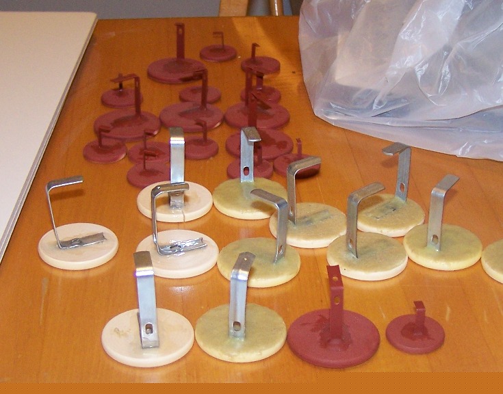

I use only a single magnet (on the plane), my flight stands are metal homemade jobbies with big staples. My Aeronef will also get magnets, but for them I'm using Brigade's clear plastic flight stands with a little hexnut that fits perfectly onto the peg of them.
One of my reasons for using just a magnet on the plane, is that I'm fumble-fingered enough that by the time I glue the magnet to the plane, I have no idea of what side of the magnet is up anymore. I need to find some plastic tweezers for these things, I use a lot of bad words in the process of gluing.
For some bigger aircraft (and spacecraft for that matter), I put two magnets in tandem on the plane, doubling the surface area that sticks to the base.

Here are what my bases/stands look like:
Chris
Personal logo Editor in Chief Bill The Editor of TMP Fezian22 Jun 2012 9:59 a.m. PST
Where do you get the mammoth staples?

boy wundyr x23 Jun 2012 7:16 a.m. PST
I found some big ones in the hardware store, used for heavier duty stapling, but regular staples are on some of the bases too. For a sense of scale, the WWI planes in the link were 1/300. I think the bases pretty good for any craft around 1-2" in length, or for anything bigger but lightweight, like plastic or 3D printing.
For some of the bigger planes I now have (1/300 WWI metal bombers and 6" Star Wars Super Star Destroyers), I realized I needed a bigger footprint for balance, so used 1.5" wooden circles as the base and picture hanger thingies, straightened out to form a sideways U, as the stand. I also textured over the bit of the picture hanger glued to the base, as it's pretty noticeable compared to the staples.
By picture hanger, I mean these things (w/o nail):
I used different sizes, up to 40 and 50 lb, depending on how tall and hefty I wanted the stand to be. No pictures yet, but I'll work on it this weekend.

boy wundyr x25 Jun 2012 1:39 p.m. PST
Here's a pic of my bigger bases, in progress:
One of my regular homemade air bases is on the right. These bigger bases are getting more texturing, both as weight and to cover up part of the hanger.
