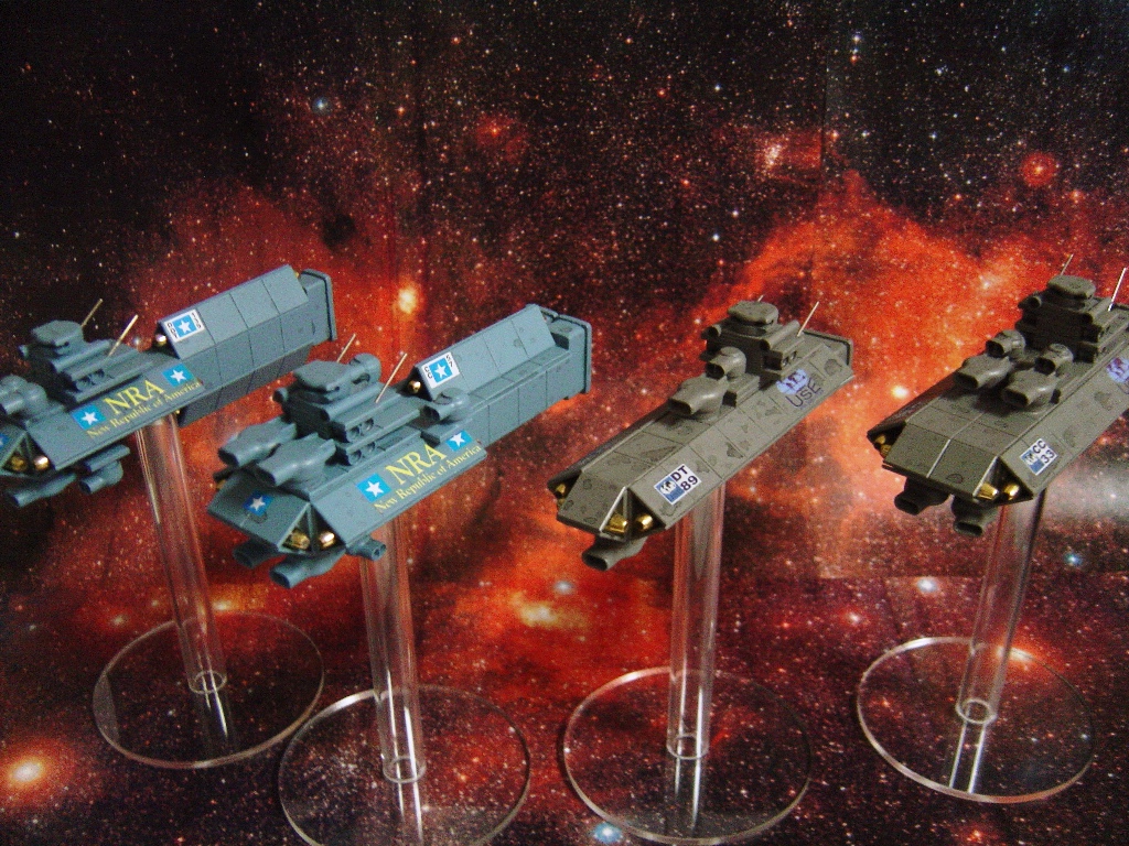

doublesix66, I'll be able to 'boast' wink here without much contention that I have probably used more magnets than anyone on this forum or perhaps even the world (quite a claim, eh?). Besides these SST mods, I've done similarly what you did (good idea you have btw, heh) by mounting magnets to several dozen custom made clear acrylic stands so that any of my several hundred scratch-made 1/1200 starship miniatures can "fly" around the floor-
These are several of my hundreds of 1/2400 scale magnetized ships (showing a DD docked in a space drydock)-
I embedded a small magnet inside of the larger ships, but the small ones have theirs exposed on the bottom. I did these years ago, before I found Nd mags.

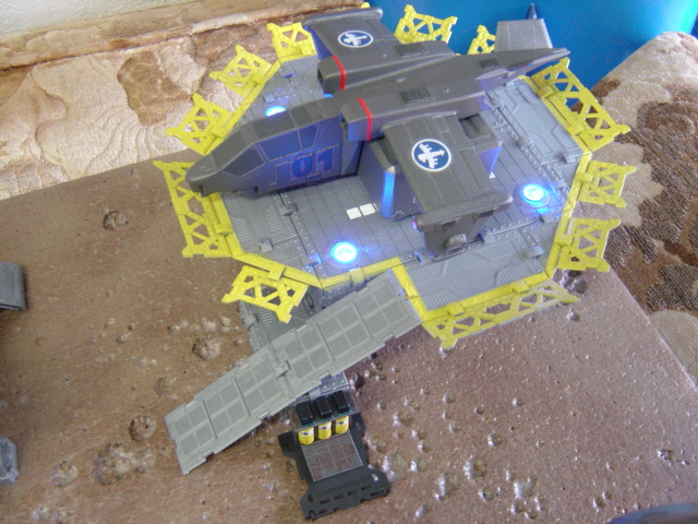

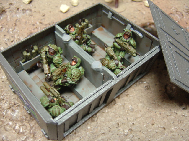

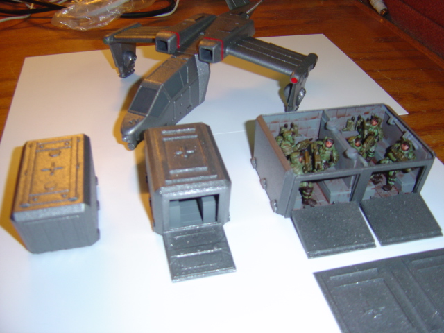

Here is a 25mm Old Crow lander painted as an SST dropship proxy, with a double-sized scratch-built troop pod. The pod has a magnetic lid as well as magnetically attaches to the lander-

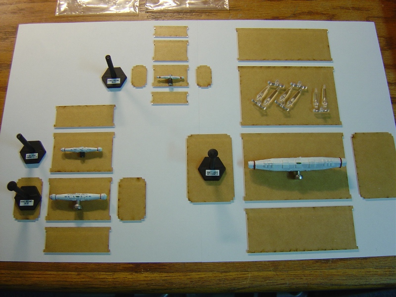

Here, I made up some modded stands for the Litko clear box prototypes that I assembled for Ad Astra Games for their miniatures for Attack Vector Tactical and Saganami Island Tactical Simulator-
Before these were available, about the only other way to use ships was to use the provided cardstock "box minis" or to use miniatures with magnets.
I made these scratch-built ships for AV:T, but now Ad Astra is selling official minis of their own-
I came up with this idea for true 3D miniatures mounting and if interested you can pick up Ad Astra's Nexus Journal 1 for the article. It's the next best thing to a hologramwink-

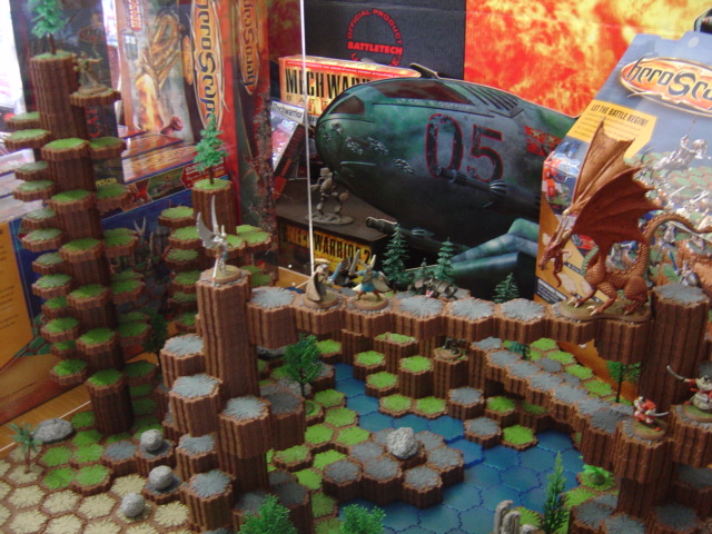

How I can 'boast'wink about using possibly more magnets than any in this hobby was just after Hasbro released heroScape, I mounted an Nd magnet under the hollow of each hex tile in a dozen sets. I could then stack the hex tiles in a way that Hasbro never thought of. I could create terrian objects over a foot in height that otherwise would fall over. A made up skybridges, rock spiral towers and "terrain trees" where their eventually offered trees are used as the very top piece of my game-functional spiral trees. By the way, I used over four thousand 3/8" x 1/8" neodymium magnets… evil grin
MUAhahahahha! wink
