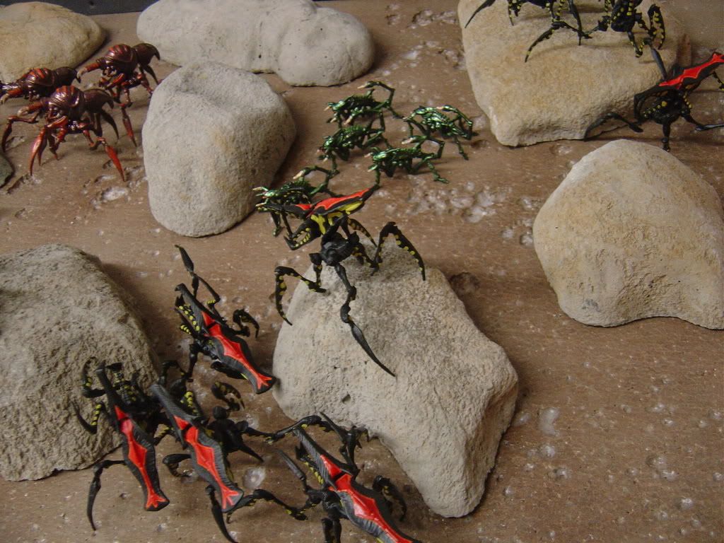

Here is a quick way to lay down some flat-bottomed "wall design" decorative man-made rocks for Line-of-Sight. They could be used as a possible prehistoric layout accessory.
Here are some sandstone "weather-worn" rocks such as in the SW U.S. I included them in a yet-to-be published article on making planet colony structures. One of my favorite ideas is the design of myalien "Exo-trees". The rocks are in the background behind the human coloy and trees (ignore the Arachnid invasion as every home has its pests to deal with wink.
