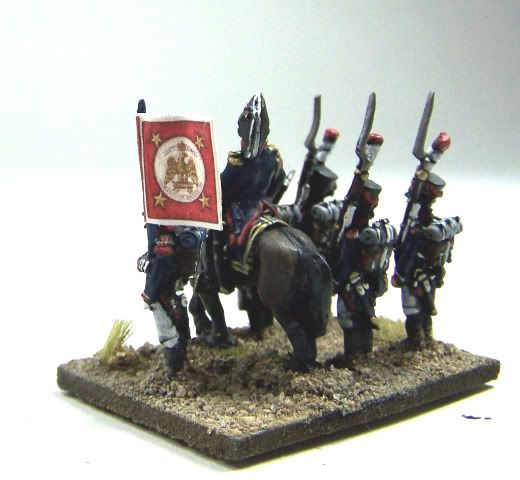

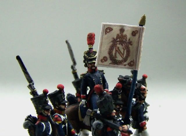

colbert13 Sep 2009 3:16 a.m. PST
DAF,
2nd picture being 1811-15 issue.
I went with GMB (15mm)
Regards,
Personal logo Der Alte Fritz Supporting Member of TMP13 Sep 2009 11:11 a.m. PST
Thank you Colbert. I should have thought of GMB first. I was thinking of hand painting the fanions, but I think that I will order the GMB ones instead.
