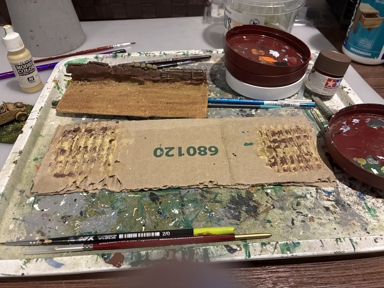

ochoin  | 01 May 2026 3:59 p.m. PST |
url=https://postimg.cc/JyYgWm4g]
My latest bit of cardboard. I saw that people were making their own textured palettes (rather than buy one!!) by gluing old bits of sprue, spare part, etc onto a plastic base- a container lid. Does anyone use such? It's obviously do-able but I think you would get a random removal of excess paint from the brush? |
