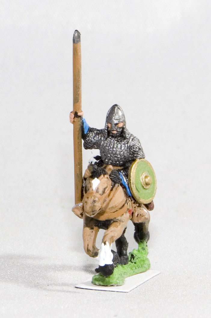

Just thinking about an Alan force circa 350 – 450AD to fight for and against my Late Imperial Romans and various Germans. Was going to use some 28mm Victrix Scythians for the light cav but give some shields and spears. My question is around the Noble Cav. Ian Heath says mostly armoured horses where as Phil Barker says mostly unarmoured horses. Would the riders look more Sarmation or by this date more Roman/Goth? Kontos or shields and spears/swords?

Personal logo Herkybird Supporting Member of TMP20 May 2025 11:21 a.m. PST
So maybe a small amount of Sarmatian lookalikes, the rest no horse armour
I would agree, except for the last sentence of Arrian's Order of battle against the Alans:
'The Scythians being lightly armed and having unprotected horses [text breaks off ]'
IanWillcocks21 May 2025 2:00 a.m. PST
Many thanks Herkybird. That seals it, no horse armour.

Personal logo Herkybird Supporting Member of TMP27 May 2025 3:23 p.m. PST
Funny, I read the last paragraph (31) as sending your cavalry against the unshielded flank meaning the Alans used shields – (as shown on several models link ) – otherwise it makes the comment on unprotected horses moot. To me, suggesting frontal horse armour is a bit of a stretch.
