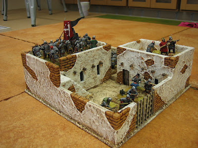

These are foam board. I sealed the edges with PVA then applied artists full body acrylic paint neat from the tube when I did the stucco on the walls (I always use tubed acrylic for this, a thin coat roughed up whilst wet. It isn't cheap but, it goes quite a long way. Unlike plaster/filler mixes it doesn't chip. Bricks are thin card applied before stucco; the stucco is put on thicker where the two meet to form a 'lip' and, on the top part of the 'bricked' walls where the stucco has 'fallen away', the paint is used to make the brickwork 'rounded'.
