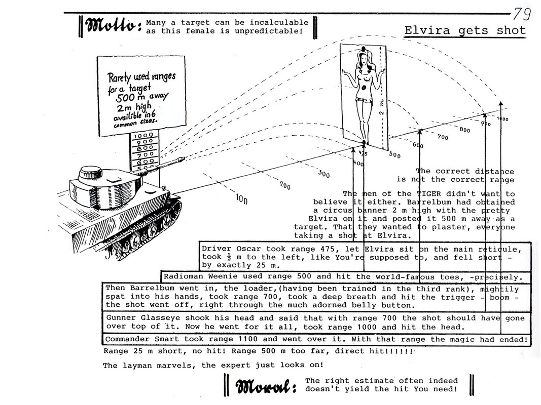

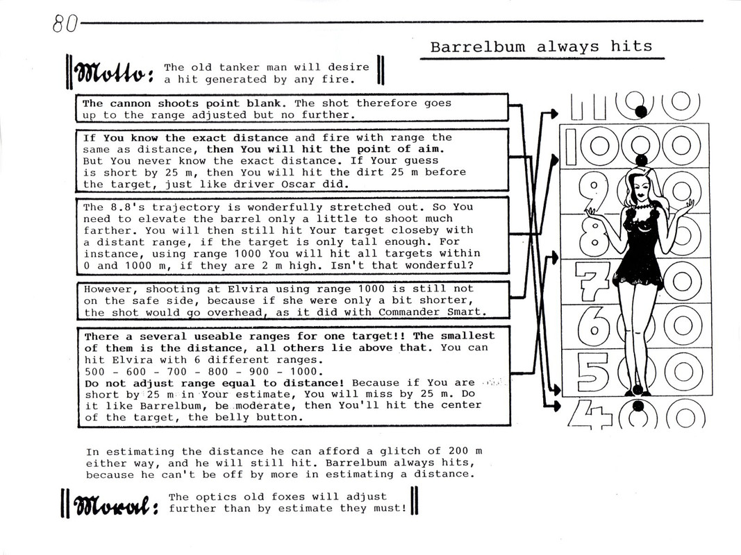

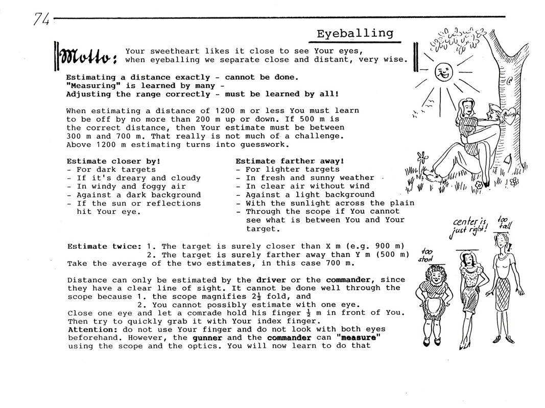

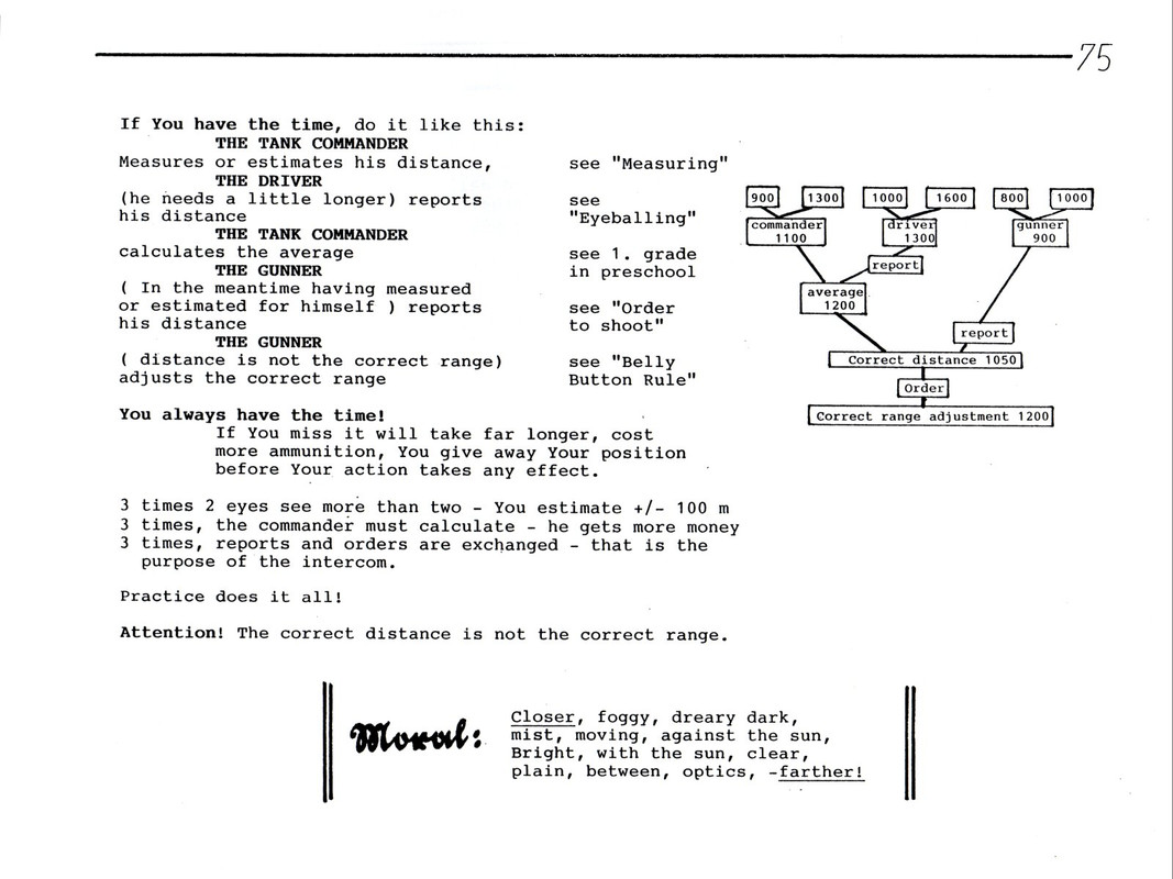

Guys, the German techniques for range estimation and adjustment had a few permutations also, and were put into the vernacular in the Tigerfibel and Pantherfibel manuals, and the manual just assumed the crews' hearts would be into the advice – so on fire for Elvira -
PDF link
Here's some scans from the Tigerfibel English translation (there's 19 pages in the manual on gunnery tips and techniques alone)!
If another page(s) seen in the original PDF linked seem interesting, I can scan those also (would be later today).

Pages 63-76 of the PDF go into detail on how the gunner used his sight as a stadiametric range finder. Here is a more detailed English version:
German reticle design
Range estimation
German reticles were designed to aid gunners estimate the width of their target in mils. Most reticles had a number of triangles that had specific mil sizes, which could be used to estimate the width and height of the target.
