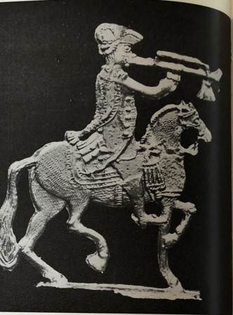

I will check Bellander "Dräkt och Uniform" next week but I am afraid there is not much information available. The only information Markelius could provide was the image of a model soldier made in 1787. It was made by Finnish caster named Erik Lodin in 1787. It seems to have the 1765 uniform och possibly Nylands or Tavastehus Dragoon Regiment. The most prominent differenece compared to the rank and file are the "false sleeves" hanging down. The same feature can be seen on Strokirch painting of Västgöta Cavalry Regiment 1748 below. The renowned Finnish historian Ole Gripenberg cannot either provide much but write that, similar to the infantry regiments, tha bugler sometimes had reverse colours on their coats. According to a regulation from 1768, the Nyland Dragoons should have reverse colours on coat and turnbacks. He also notes that the regimental commander had certain freedom to design the uniform of the musicians. From a wargaming perspective this gives a lof of freedom. Personally I would reverse the colours for buglers during the early period up to 1806, and maybe add the "false sleeves" with green stuff, especially since a lot of old uniforms were still in use by then. For the later period it would make sense to have the dragoons with swallows nest and sleeve lace(see Perry miniatures). Hussar buglers I would have like the rank and file (maybe just reverse the colours of the hat ornaments as can be seen below)
