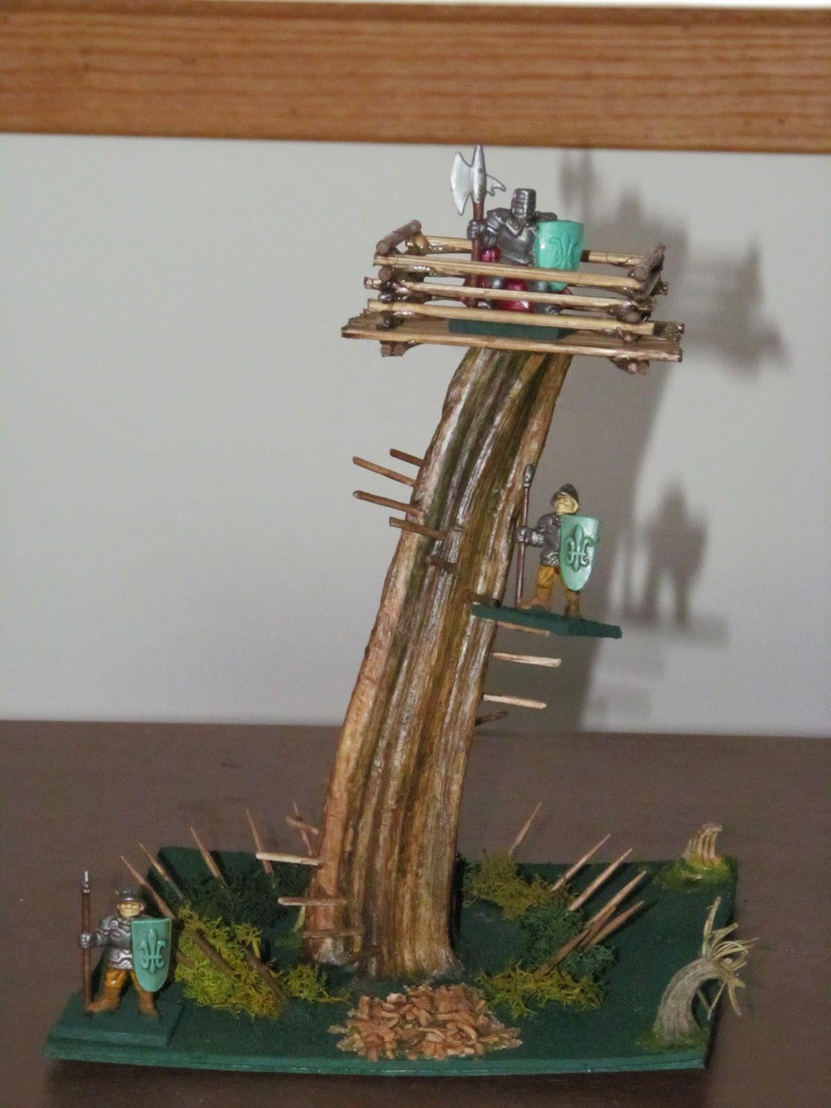

MDF is my go-to basing material, even for larger terrain pieces. I used it in 4-inch squares, to base Guard Towers with a pumpkin stem as a cut-off 'tree', with a logged, 'raft' platform on top, as the Guard Tower.
Originally, I used two layers of vinyl floor tiles for my bases. The vinyl warped (the warping can be seen in the base), after a few months, with the same PVA Glue + sand, texturing applied to it. I had to re-base every one of my 12 Guard Towers, and that was a lot of work.
Now I solely use MDF. Could not be happier with the material! All 12 of my Guard Tower bases are as flat as the day I attached them, even after texturing them with PVA Glue and sand. Been flat for many years post re-basing.

I like the ladder up the tree trunk, Sgt. Slag!

Thank you, Grelber. I modeled those after a piece of fantasy artwork I found in a RPG gaming module booklet. I thought the artwork was brilliant, and I searched around for ideas on how to make a model of it.
Autumn rolled around on the calendar, and I had a "Eureka!" moment looking at pumpkins for sale. I searched e-Bay, and I found that pumpkin stems are sold for crafting purposes! I ordered a set, and I was off to the races.
The pumpkin stems are a bit brittle and delicate -- they're not made of wood fibers, more like brittle plant fibers. I drilled holes into them, and then glued toothpicks into the stems, to re-create the pole steps, in the drawing. I did a similar thing for the platform on top. I skipped the roof, as that would have been problematic for gaming with them, losing access to place minis into the platforms. They are now 10 years old, and have changed very little, since they were built. Here is my blog link to the relevant page, Project #2, scroll down.
My thoughts were that the builders would plant buckthorn bushes between the stakes, to discourage attackers from getting too close…
They were a blast to build. They've been even more fun to game with! I've used them several times, but I need to use them more often. They're just a hoot to game with. Cheers!
