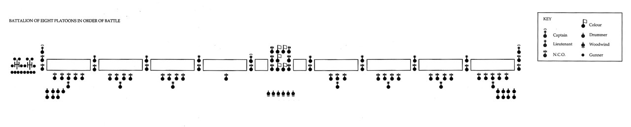

For a typical unit deployed in Line, where should I properly place the command figures? Colours, drummers, officers, etc. Somewhere once upon a time I had a very nice diagram of how it all went. Organization by company, including some of teh basic evolutions for movement and formation changes.

Badgerlock16 Mar 2023 12:42 p.m. PST
From Duffy, diagram of a Prussian battalion of eight platoons showing NCOs, musicians, etc.:
