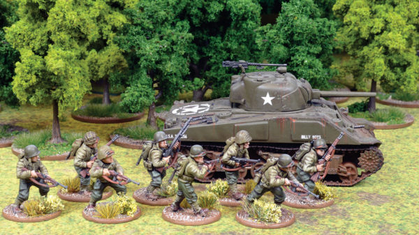

blank frank05 Feb 2023 7:18 a.m. PST
Didn't someone post a photo which compared a war time Sherman tank with infantry hugging the side with a photo of Bolt Actions Sherman and figures similarly posed to show it was too small?
Anyhow we didn't have this problem back in 70's mixing Airfix with Rocco minitanks was never a problem :)
Arjuna05 Feb 2023 8:24 a.m. PST
The Bolt Action Sherman may be 1/56.
Assuming it is, he can't be too small, simply because he is the scale they specified.
The Bolt Action Infantry is something else.
Probably about 1/50.
And not just because they're standing on their bases.
Note, they run ducked, the guys from the 9th at Sprimont on the historical photo not.
The Bolt Action ones are much bigger and fatter than the real ones.
So, see you in thirty years for the next round of this game.
But on a side note, what exactly are those trees and who tends the grass bushes under them?
