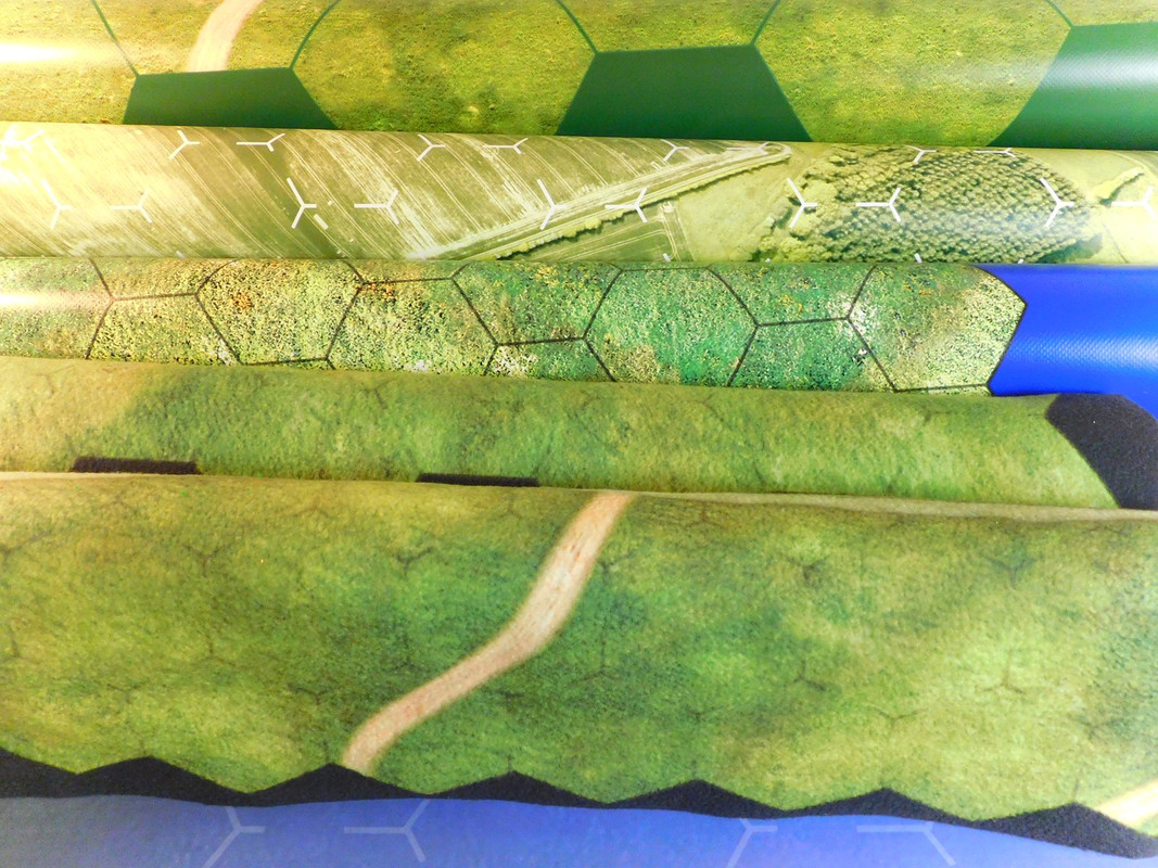

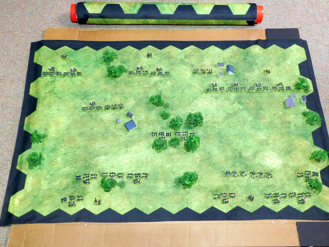

FlyXwire27 Jan 2023 6:26 a.m. PST
I've made many custom and accurate hex mats printed out on vinyl and fleece.
Two Battle Cry 3D conversions mats here on fleece, that easily take hex hills placed underneath, as an example -
You roll up mats like these -
I don't recommend folding up any mats for storage, or for transporting (with or w/o hexes).
Bashytubits28 Jan 2023 11:09 a.m. PST
Those Fleece mats are very impressive, did you use a template to score the hexes?
FlyXwire28 Jan 2023 12:36 p.m. PST
Thanks Bashytubits!
The hex grid was done digitally, and so it's all part of the image file that's completed on a desired material from the print company.
