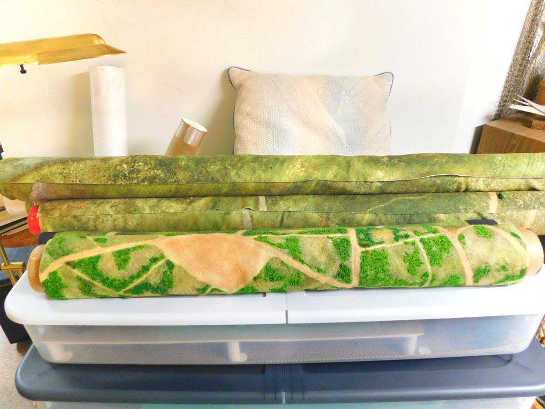

How do you store and transport these cloths with terrain glued on?

FlyXwire18 Jan 2023 5:29 a.m. PST
I store them anywhere I can find some open space. ;)
Seriously though, I use shipper tubes to roll them around. I cut three squares of double-sided carpet tape, and affix these positioned at intervals in a straight line across the length of the tube. When rolling a mat back onto the tube, it's a matter of fixing one edge of the mat across the tube's length using the tape guides, and then just drawing the mat up by rotating the tube till you've got a bundle rolled up ready for future deployment.
