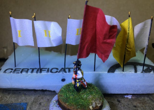

Many of the current rule sets are requiring some type of token or markers placed on units to denote either strength, status, or orders. I'm not a big fan of having these tokens laying around on the table. There had to be some way (other than bookkeeping) to mark the units.
Recently I was reading a posting on TMP where a gamer commented that he had extra command figures, left over from his current project. This got me thinking, I too has extra command figures, how could I used them. Maybe this second problem could be used to solve the first.
For years the folks I game with have used casualty figures to represent disorder or disruption with their units. So why not use the extra command figures to replace the tokens? But, how do you identify what the figure represents? Flags.
Going through my leftovers I pulled out the standard bears, officers, or any figure that looks like it could hold a color. I then drilled out the hands so a wire flag staff could slip through them. I then made up a set of flags that could be switched off for the figures to hold. The flags I made in two groups, one in solid colors and the other set has numbers on them. The solid colors, represent specific action (these were just cut from gift tissue). The numbered flags are use if you need to keep track of hits or such (I never like placing a die behind the unit).
I painted my token standard bearers in generic period uniforms so they could be placed behind any unit in any army. If I would do this again, I think I may just include a figure within a unit. Another thing I would do differently is with the numbered flags. I made white flags with gold roman numerals. This color combination is not all that visible, so the next batch just maybe white with black dots.
Hope some of you find this useful.
