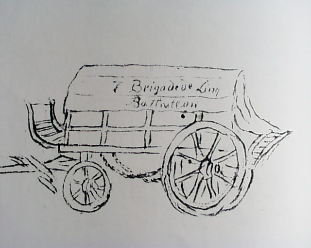

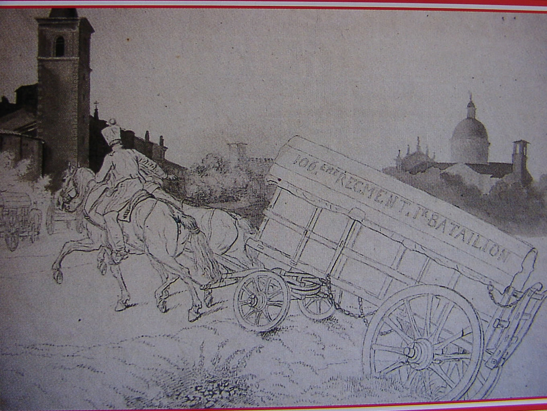

a very interesting topic, about the markings, yes and no, I did see on contemporary images quite a few without markings, mostly sort of civilian waggons used for transportation, required on the spot and never handed back, but also sort of regular waggons issued by the army, here some examples where clearly the markings can see seen, in case anybody has those immages of higher resulutionit would be highly appreciated

Michman20 Aug 2022 2:16 a.m. PST
@von Winterfeldt
Excellent info and images – many thanks !
From top to bottom, I copied the location and year for each :
--- A. Zürich 1799
--- B. South Germany 1800
--- C. Russia 1812
--- D. Beresina 1812
--- E. Leipzig 1813
from Fournier-Sarlovèze ….
from Geißler ….
