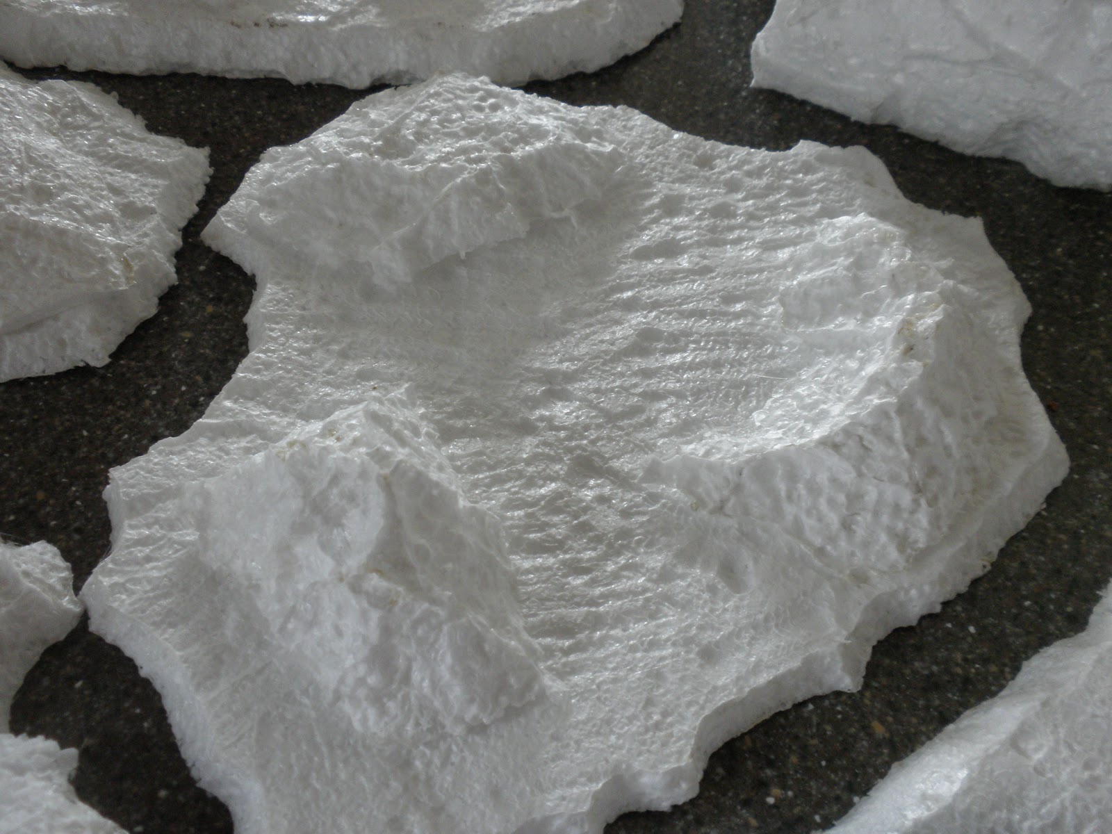

If you just want hill shapes, skip cutters altogether. Just snap your foam into something a bit bigger, then melt the sides to shape. You can get slopes, cliffs, even rolling hills. I like heat for melting, but some folks like chemicals. But let use stick to heat for now. Most anything that gets too hot to touch will work, old flatiron, soldering iron, hair curling iron, also hot air sources, like old hair dryers, heat guns, butane torches, even cigarette lighters. Open flame is clearly a danger, but you need a way to snuff a flame no maker what heat source you use. Place the snapped off foam with a side you want down against some flat surface like a stone counter top, or sheet of metal, and melt the edge back with the heat source. The foam collapses into itself making, often, natural looking shapes. The flat surface soaks up heat leaving the bottom level.

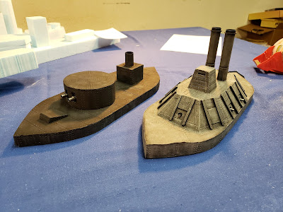

Anton Ryzbak22 Apr 2022 8:50 a.m. PST
I second the vote on the Proxxon 115e link , best hundred bucks I ever spent on a tool. I have been making things for years without a hitch. It works like a table saw or a jig saw and has tons of after market accessories. Just a few of the things I have made:

DyeHard26 Apr 2022 8:17 a.m. PST
I do not have any photos of my own right now, and stuff packed away. But I did find this example on the web:
I would always assume that something unpleasant will come off or out of melting foam, best done outside. But it would be a function of your tolerance and the size of the project. Heat alone should just collapse the foam structure, but who knows what the puffing agent was. A side benefit is it forms a "crust" of more solid plastic, so stronger and tougher.
