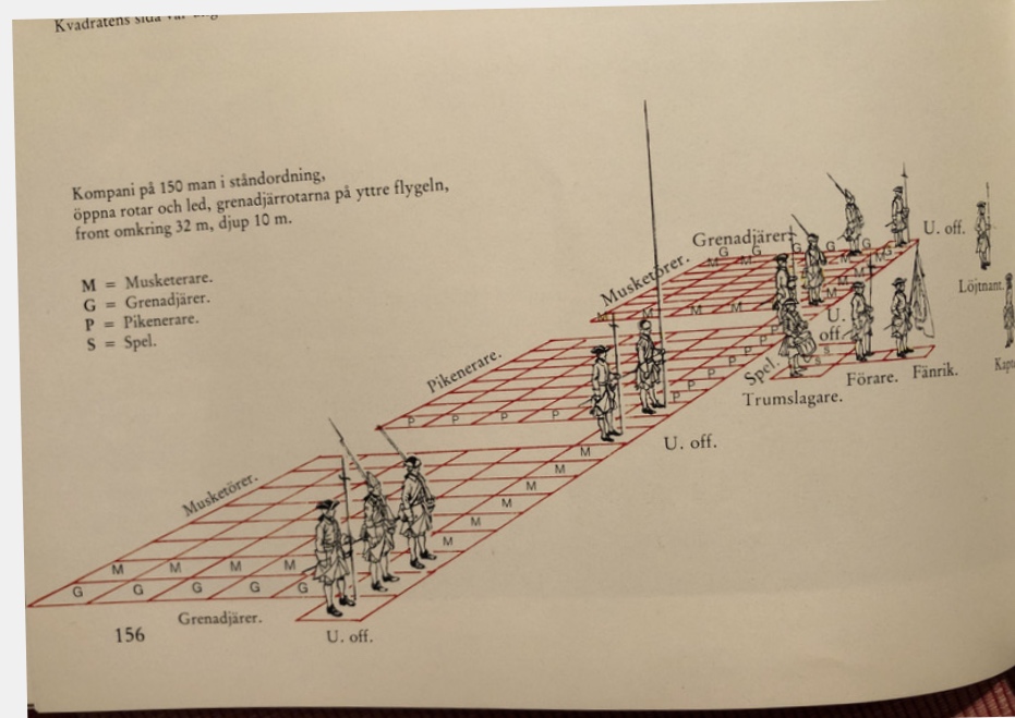

hornblaeser22 Jan 2022 11:26 a.m. PST
The swedish formation with pikes as a middle rank i a defensive formation against cavalry. I think it was a 6 rank formation. The pikes could then be turned front and rear.
The normal formation was a 4 rank, but not with a central block of pikes but as small block of pikes and muskets along the line as the were organised company wise.

Travellera22 Jan 2022 11:30 p.m. PST
Good point from hornblaeser. This is thebtypical setup for each of the four companies in the battalion:
