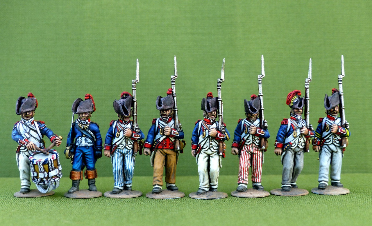

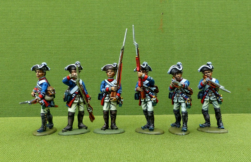

I bought several of those GW paints, the idea is to accelerate painting without cutting too much quality – I used Perrys Plastics Bardin French, an older plastic set – where casualties could be accepted.
I used Corax White as primer (which I wouldn't do again, there is makes some of the paints look very faded, I have to try out the other recommended primers from GW.
Mainly I used to paints out of the pot along with a wet palette and thinned down some of the darker paints with Contrast Medium.
The Contrast paints provide a very thin and delicate paint layer.
Also I did mix quite a bit to achieve the desired hue, like after one miniature in pure Leviadon blue – then a mix with Ultramarines blue.
On one of the Swiss miniatures I did use a wash of Alys Brown Liquid, the other is just Blood Angels red with a bit of Gryph Hound Orange.
As for the faces, I used all three flesh colours and on some few faces I added on top conventional flesh paints to improve, so let me know if you could spot them.
Those miniatures with a brown base, I did paint conventional on and off at my usual painting sessions, to try out some techniques, so there is a direct comparison.
There is certainly room for improvement but first let's see how those miniatures turned out.
The only exception are the miniatures in white uniform, which I had to paint conventionally – as all the white belts and straps etc, there I could not stand the result of Apothecary White and yes the name of the paints suck.
Also they have to be shaken vigorously so that no pigment is visible at the bottom of the containers.
I tried not to overdo it, like painting Ns on the turn backs – but still do a decent clean paint job.
url=https://postimg.cc/YGtYqxJv]
url=https://postimg.cc/06Y7s4Hg]
url=https://postimg.cc/2L6WnSjm]
url=https://postimg.cc/7GX7C2km]

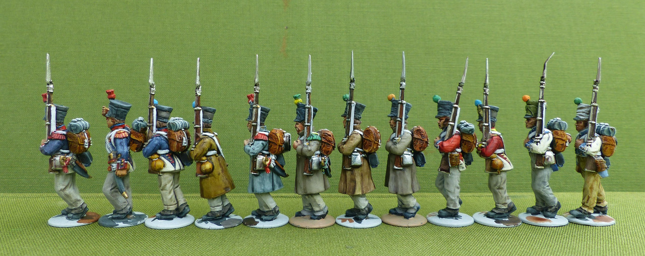

Here, white primer and then Contrast paint. OK the result not as good as with the conventional method, but more or less acceptable.
url=https://postimages.org/]
url=https://postimg.cc/HjFn500D]
Those above painted in the conventional way, at the moment I cannot see a way to replicate this with Contrast work so more experimentation is needed, and then I can live with a lesser standard as above photos there on the other hand I reduce painting time by a half.
