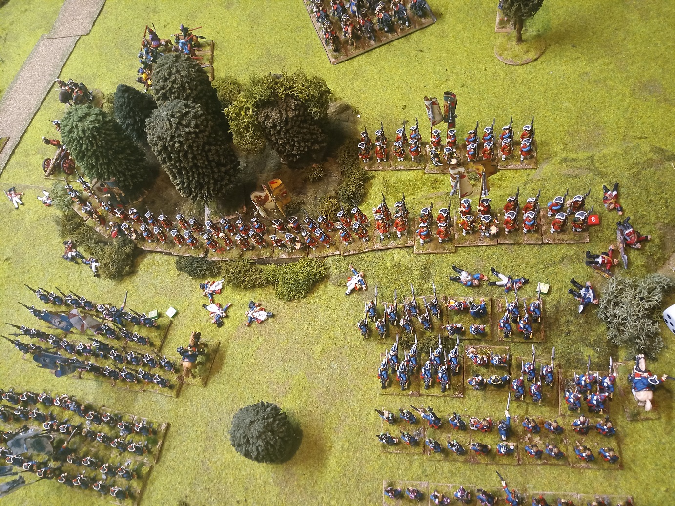

Decebalus16 Sep 2020 5:05 a.m. PST

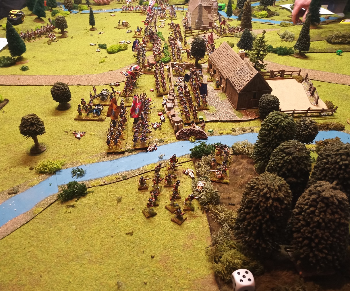

Cloth with latex caulk (like the selfmade caulk mats) can be made like every terrain piece: with sand, flock, color etc.
This is a picture from TMP (nt from me!) showing a caulk road. You can make wood bases with the same techique.
rampantlion16 Sep 2020 5:47 a.m. PST
Decebalus, that looks really nice. What type of cloth did you use? How difficult would it be to do a 3' x 4' mat using that method and adding flock, static grass, tufts,…etc as you go? I was thinking if you add the tufts while it is still wet that they might stay on the mat better, not sure though. Maybe adding them with glue later would be better and doing all of the dry brushing first would be easier. Do you have any experience with making a whole mat this way? It might try one. Thanks for any info.

jwebster16 Sep 2020 9:06 p.m. PST
Making terrain cloths using caulking is so easy, a couple of 10 year old girls can do it !
This is not method that I would recommend, unless you really enjoy cleaning up afterwards
The only thing you need to watch out for us curling up at the edges on smaller pieces
I made metal bases for forests so no curl up, but only really practical for dba sized terrain. For dba style rules, do not permanently attach any trees to the base
I would start with felt, Maybe darkish brown, Some drybrushing in various shades. Some spray glue and little flock in darker woodland colours. I'm making this up as I go along
I do recommend that you base the trees in clumps. Single trees are extremely likely to fall over
