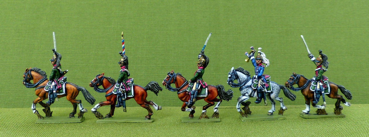

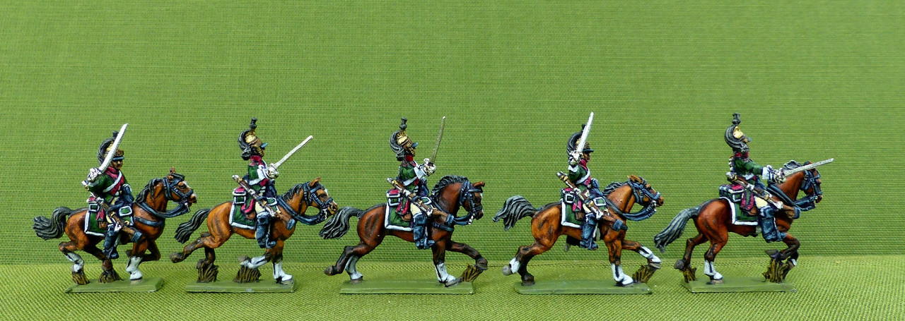

von Winterfeldt14 Aug 2020 7:02 a.m. PST

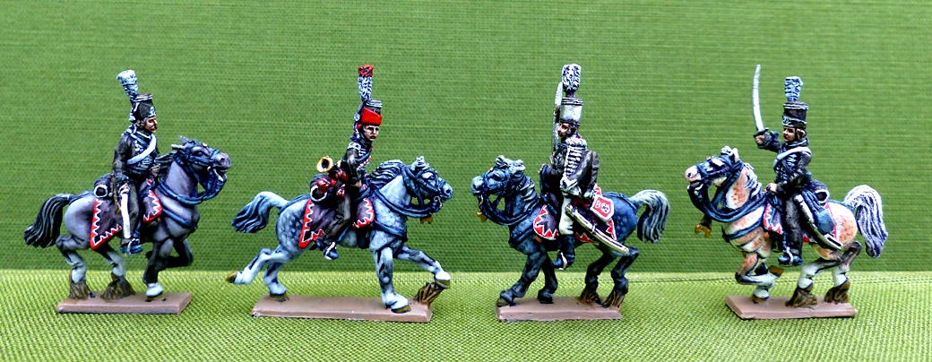

In contrast to the well pampered AWI collectors or spoilt Boney enthusiasts, the French Revolution collector has sometimes to do with makeshifts.
Those are early French Napoleonic Dragoons, and there AB is usually quite keen in research and detail he did for cartridge pouches and sabre the M 1801 pattern, still what could I do – my French infantry needs at least some cavalry as well.
To realize the incredible microscopic sculpting you could open the photos in a new window to get it in bigger outlook and admire the stars at the rosette where the chin scales are fixed to the helmet – incredibile.
For the guidon bearer I have to find a producer who does such Dragoon guidons for about 1793.

Fantastic work – thanks for sharing

Very, very nice indeed, Von W.
Those are arguably the best French Dragoons I've seen in 18mm.
My compliments!

von Winterfeldt15 Aug 2020 10:34 a.m. PST
thanks for all the compliments, the downside those dragoons are really post 1800 – I would wish to got those sculpted as Lejeune or Hoffmann show them.

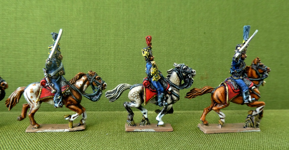

stephen116220 Aug 2020 8:05 a.m. PST
I especially like the horses!
What kind of paints are you using?
Stephen
von Winterfeldt20 Aug 2020 12:06 p.m. PST
I use acrylics for under painting and then artist water colours along with paint flow improver.

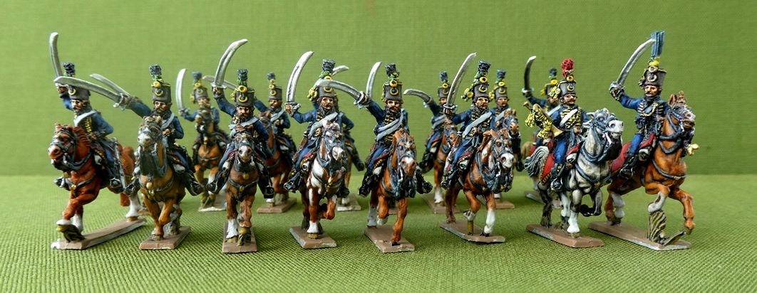

Thanks for all the comments, I am a bit surprised that the French Dragoons got such glowing comments, compared like with my Austrian and Prussian hussars which were much more difficult to paint, but are they so much worse compared to the French Dragoons?

The hussars are, in truth, also very good.
"but are they so much worse compared to the French Dragoons?"
Fishing for compliments, perhaps ?
