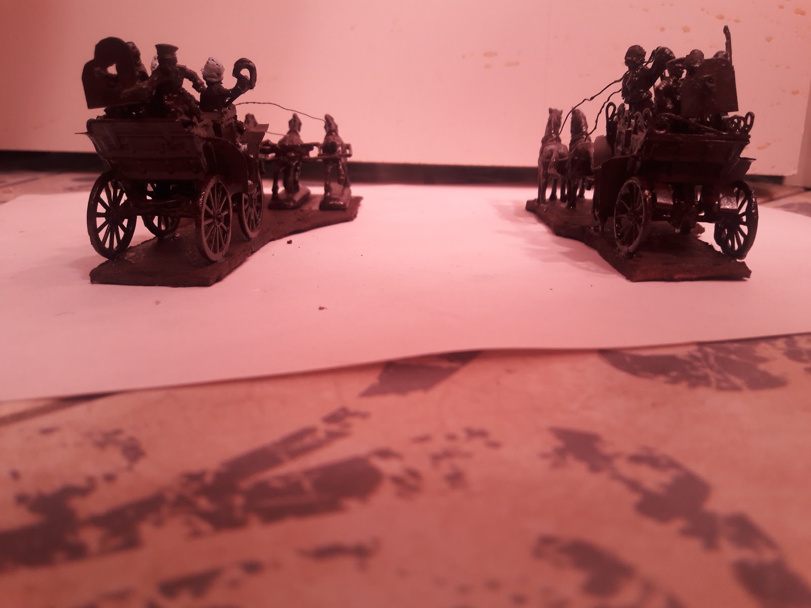

Hi all, i wanted to share my early progress on a tachanka ive been scratch building in 1/72. Id love to hear any comments, advice, suggestions etc. If it doesnt come out terrible, ill make 3 or 4 more:

Costanzo127 May 2020 11:31 p.m. PST
Nice!
Major B28 May 2020 9:59 a.m. PST
I really like what you are doing. Please keep us updated and if successful put up a list of your materials (ie what type of wagon). I have an RCW project that stalled because I could not find a reasonable model.
Umpapa28 May 2020 12:01 p.m. PST
I really love Your work.

Makhno191828 May 2020 12:26 p.m. PST
Thats amazing, i love the box art. Thanks for all the encouragement, I'll definitely keep updating with my progress. In the meantime, if anyone has suggestions for me around the wagon springs, i dont love my solution, which is pretty much just random plastic enough to hold the cart up at the right height.
Thanks again

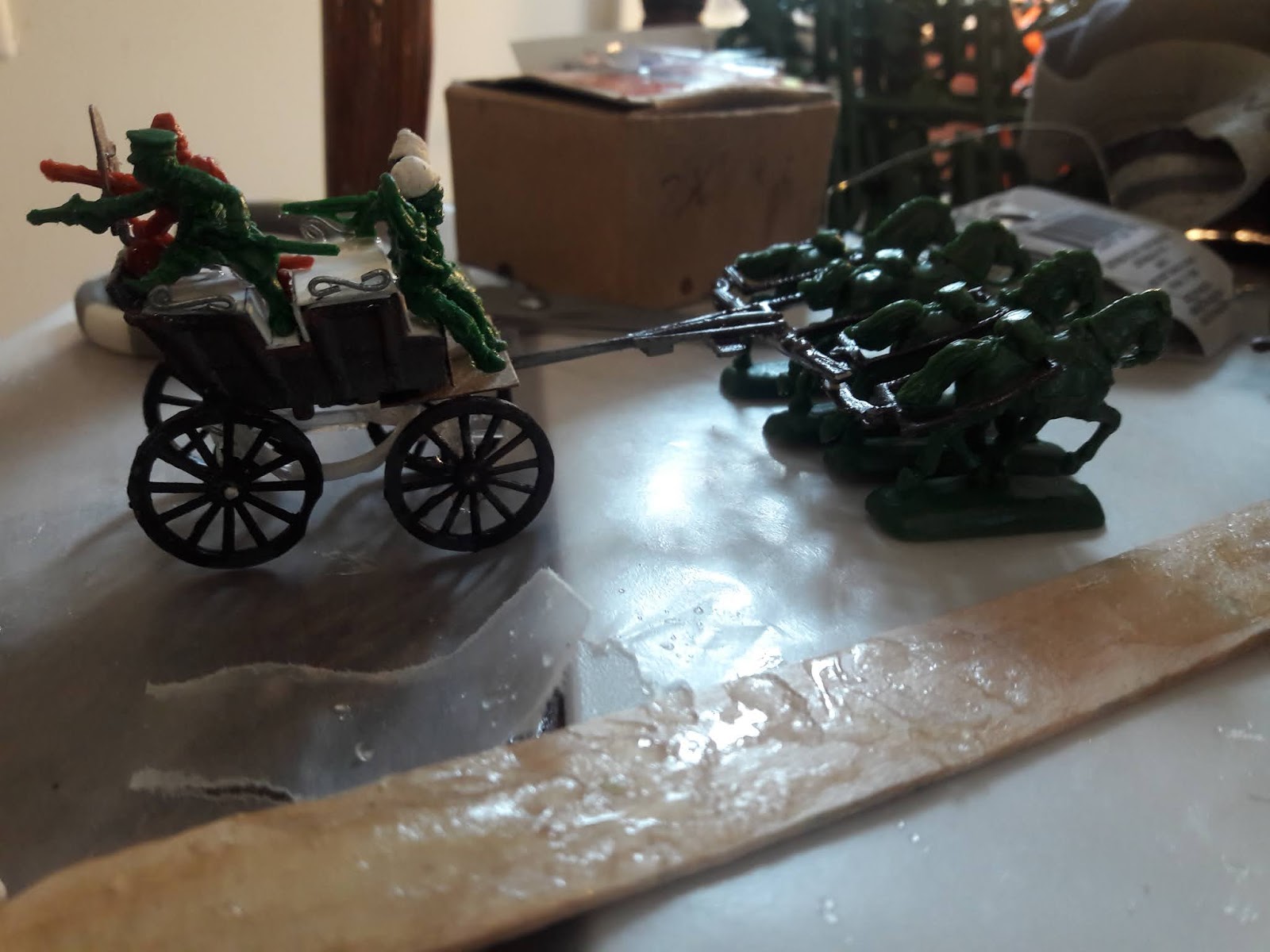

Makhno191805 Jun 2020 8:53 a.m. PST
Thanks again Miko O. Ive got my eye on that HaT set for future attempts. The diagrams you've shared have drawn my attention to how thin the floors should be. Theres pretty much no structure beneath them, other than the springs and axels. I had been thinking id cut up one last of those wagons ive been using, either in half to make 2 as i did before, or i was thinking a longer section might look better (mine seem a little short on the horizontal length). That said, mine also seem too tall on the verticle length, probably because of all the structure i have beneath my floors. I'll likely try to emulate your mockups using cardboard or something cuttable but strong for the sides, and cardstock for the floors and seats.
In the meantime, i posted some updates on my efforts. Ive gotten a 2nd, similar tachanka to about the same state as the first: ready to be painted.
Heres the post: link
The new springs, thanks for the advice guys!

Makhno191823 Jun 2020 5:40 a.m. PST
Hi all, some more updates. Ive been working on a 3rd version based loosely off of Mike O's plans.
A couple questions for Mike O: do you mind if i share the photos of your plans above on my blog?
Could you also share some of the measurements of your tachanka? I was guessing, and it came out too large i think.

Makhno191824 Jun 2020 2:43 p.m. PST
Hi Mike O, thanks. No problem about the plans, totally understand, just let me know in the future if you end up with a finished product to share. I appreciate you sharing them to begin with. Though my blog readership is just the few of you who click the links from these threads😉
I see what you mean about the front seat height, ill note that in my next effort. I like making the hand rails with wire, as i learned making street lanterns for my telefonica diorama (which i swear ill finish when i stop procrastinating with this horse play…). The only thing i changed from your plan was i reduced the height of the section between the rear seat and wheels, as that area looked less substantial in the photos i found (though I'm sure they used all sorts of different carriages).
I appreciate your suggestions! I was eyeing the self-healing mat, not sure its in the budget yet but someday. Ive just been using a ruler and cutting boards. You're right about the king's measurements. I always blamed that on you English, but i guess we're the ones still using it over here. Im sure some other forum historian on here will tell us the story shortly.
Photos, yes, guilty. I should have thought more about the lighting, and put the camera on something steady, but it was tricky to get any of the details to stand out when theyre all dark brown.
And the positions of the horses, yes i see that now. The graphic you shared earlier from this site illustrates it really well
Ill have to shorten the distance and cut down the bases. Thank you for pointing it out. The horses i got from the contesa wagon sets attatch to each other at the center of their sides, so perhaps its not an ideal set, without some extra knife work. Ive bought HaT French and Austrian limber sets recently ill use on my next efforts. I couldn't find the Napoleon accessories set you mentioned, must be discontinued. Too bad, those riders look like they just need some rounding off on the hats and other easy knife adjustments, plus some weapons.
Anyway, thanks as always for your input!
