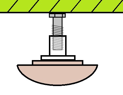

So I'm thinking of how to model landing pads on the barge. I have the legs built from parts of the Airfix bridge. The bridge pieces are narrow, even when doubled up. They are too narrow to spread the mass of the vessel. I am trying to decide if I want to run a longer thinner "foot" or several wider feet along the length of the structure. Any thoughts?
Personal logo etotheipi Sponsoring Member of TMP12 Apr 2020 8:27 a.m. PST
I would go for a small number of larger "inverted mushroom" feet. If they were on hydraulics, then they would adjust for landing level on uneven surfaces. If you made them by putting a wood finishing button upside down on a long collar nut that rides on a screw attached to the bottom, you could actually adjust them.
For VSF, I think I would make racks on two sides and hang the ramps. Then the lackeys jump off and deploy them manually. I think that would give you a good Victorian mix of high tech and grunt labour.

Personal logo etotheipi Sponsoring Member of TMP13 Apr 2020 6:00 a.m. PST
So drawing a picture helped me figure out how to describe the landing pad thing.
Fix some bolts to the underside of the barge, facing down. The picture doesn't show, but you might want to countersink them.
Glue a wood button to a collar nut to make the foot.
Flip the foot upside down and screw it on to the bolt.
By adjusting how far you screw the collar nut down the shaft of the bolt, you can adjust the height of the landing pad. Since they will all adjust independently, you can land level on uneven terrain. Within the tolerance of the bolt and collar size.
tsofian13 Apr 2020 8:22 a.m. PST
That is a great idea. Unfortunately I already glued the bridge side rails in place! I will use it in the future though!
