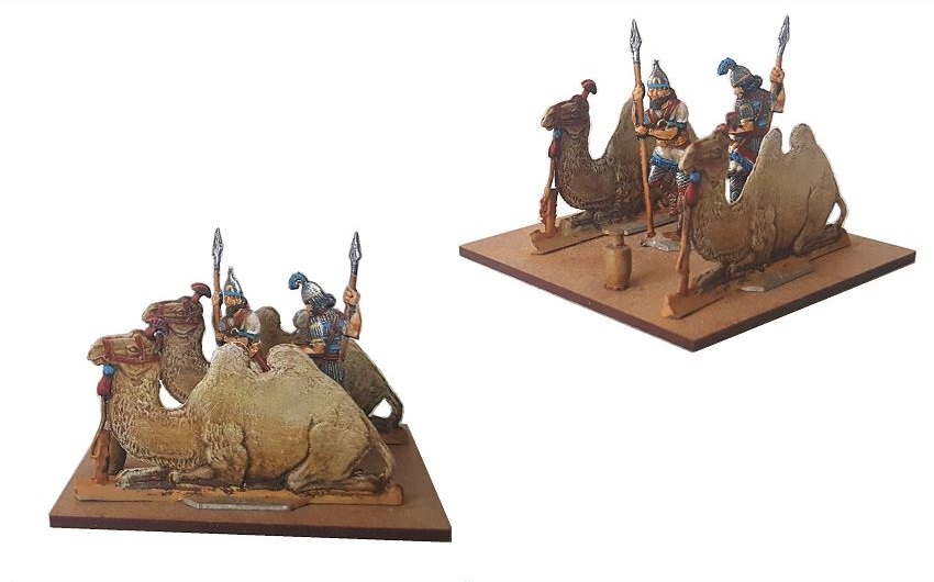

Yesthatphil19 Jan 2020 8:46 p.m. PST
I use a mix of paint media … watercolour, enamel, oil as well as (these days, near ubiquitous) acrylics. Particularly on flats, I like the effects you can get with oils – like on these camels.
