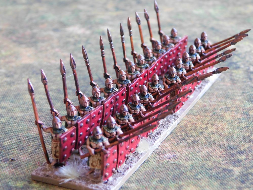

I couldn't face painting the 288 spearmen for my new Museum Miniatures Sumerian army my usual way (undercoat, base colour, highlight, top highlight), so I gave the Contrast paints a try.
In the pic below, the flesh, kilts, spear shafts, cloaks and shields are painted with one coat of a Contrast paint each. Only the bronze is double-painted, but that's using non-Contrast paints. I can paint 12 figures from start to finish in about 40 minutes. I'm sold on them!
