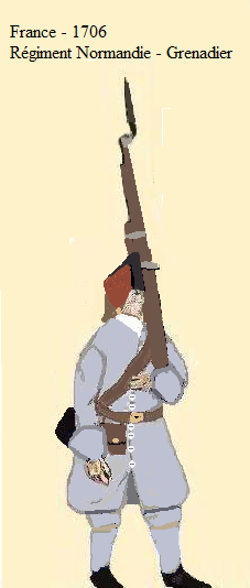

This was a problem of mine for my Battle of Turin 1706
I came to the same conclusion that they wore a tricorne. Then I asked opinion to Richard (with which we are doing the WSS Kronoskaf Project) and he found sources that they had fur caps. Also, in the Piedmontese chronicles of the time I read that the Piedmontese said "we saw 300 Grenadiers attcking the ramparts" and a lot of time it is point out that a grenadier unit did this or that. Now, if they were identical to infantry (tricorne) it would have been impossible to distinquish from the normal infantry … moreover, the Piedmontese Army in WSS wore uniforms totally based on the French ones; this is sure. And the Piedmontese grenadiers wore a low fur cap; all this brought me to re-consider my opinion and draw French Grenadiers with fur cap:
FRENCH GRENADIER
