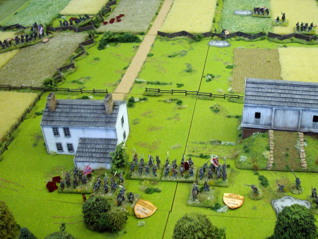

The first time I tried this stuff was when converting the Battle Cry board game for using little "flats" made for unit pieces in a 3Dized version of that game -
(we're only limited by the skill we can cut the outlines out with our scissors)

Some more examples of types of game markers that can be made with Shrinky Dinks plastic (the red hearts seen below are commercial-bought products) -
The black powder (reload) markers seen served double-duty as broadside firing indicators for Sails of Glory.

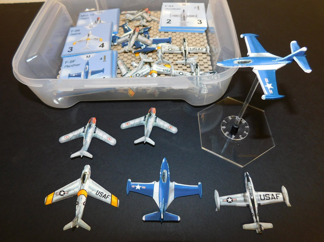

Here's some more spam for Nick's thread – Shrinky Dinks game aircraft. These were made from profile artwork off the web, and printed out to a rough scale to each other, and at a size that estimated their shrinkage rate size post-baking. Some of the vertical and horizontal tail surfaces were separate pieces glued into place and/or slotted into place like the old balsa wood, rubber-band powered toy planes were assembled.

You've done some really cool things there FlyXwire! MiniMo – I like the translucent effect too and the hole punch would make life so much easier.
Looking at what you've done I reckon I've barely scratched the surface of what can be done with these – those planes look very cool.
