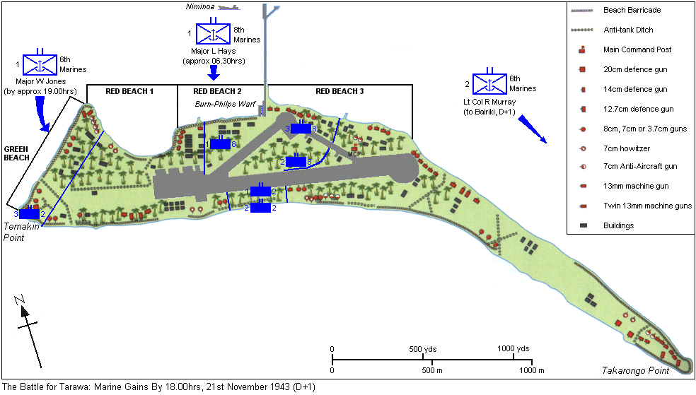

More however, the USMC map of Betio defenses
doesn't show any of the 25mm guns but does show artillery
sites of 3 calibers, including the 37mm ( smallest ) .

The other resource I consulted ( link )
shows no 37mm, but does show 25mm, so I am confused.
