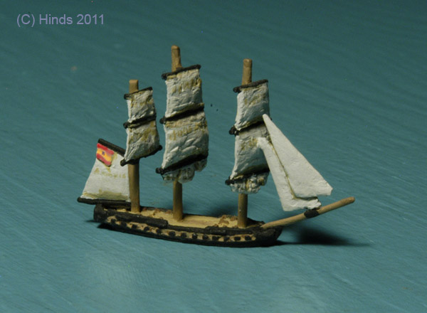

Probably too late, but … example of Figurehead 1/2400 (large frigate). I shortened masts a bit to better match contemporary prints, and angled them and the bowsprit accordingly, and yards/sails braced as if wind on port quarter. Model is pretty sturdy, even without rigging (note jib glued to fore topsail). Also, was going to experiment with token rigging using "Beadalon" .015" wire. My flags are supposed to be made from adhesive label paper, adhered to the spanker, to allow change of nationalities.

Use beadlon wire for the standing and running rigging. It is multi-strand stainless steel wire coated with nylon (black nylon is what you want). Cut with scissors dip both ends in white glue and place on ship. Hold with tweezers and you may have to try several snips to get the right length. This wire is very strong (30 pound 50 pound test?). It not only keeps parts from moving apart, but also resists things moving closer together- the wire is a bit stiff and will bow a bit like a spring. You can drop the ship and it will hold together. link link
hindsTMP21 Mar 2019 7:34 p.m. PST
White glue? Interesting; maybe I'll try that.
Here's a Photoshop mock-up of what I'm considering. So I have absolute minimum standing rigging, consisting of IMHO the most visible from a distance forestays and backstays (16 pieces of .015" Beadalon).
Now I know this looks bad compared to some of the nice 1/1200 models on these boards, but remember the ship is 1/2400 scale, and overall is only 1 3/16" long. Shrink your browser image down to that size, and look at it then. I think it fills in the blank area around the lower masts, at an acceptable effort. We'll see… :-)
