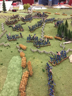

Personal logo Extra Crispy Sponsoring Member of TMP08 Dec 2018 1:18 p.m. PST
I use a felt color called "Reet's Relish" from National Non Wovens. It comes in 6' widths on bolts as long as 50 yards. Our club buys them in bulk.
It is an olivish green – MUCH nicer than that Christmas green that looks like crap to me. Even better, it is not a solid color, but flecked with darker and lighter spots.
Here it is in action. The mottling is in the fabric, no rattle cans needed:
