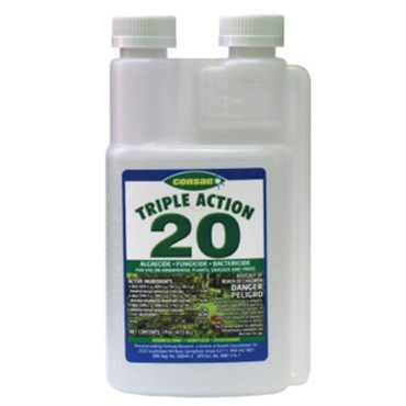

Cacique Caribe24 Sep 2018 1:36 p.m. PST
If it's a porous material like mdf, bleach can only help for a short while.
A light and very diluted misting of this (read instructions on back), or your local equivalent, should take care of your problem for several years. It kills the fungus and prevents all new growth.
And, after it dries thoroughly, make sure to spray everything down one last time with a matte polyurethane sealer.
Dan
PS. If your storage area is that damp, you should consider putting a small bag of desiccant in each bin. At the very least.
