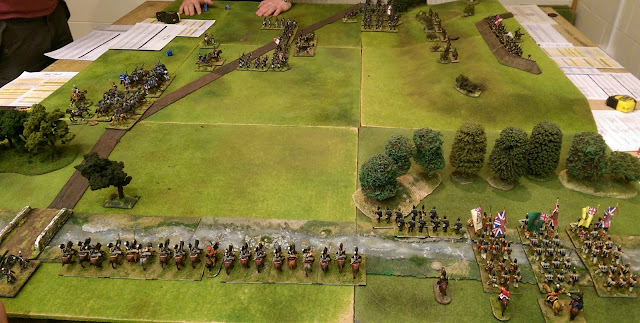

Jabba Miles27 Sep 2018 2:07 a.m. PST
A couple of my games not on 6x4 but close. Rules BP, basing to Shako 2 scheme.
First 6x6
Second 6x5
Tony
