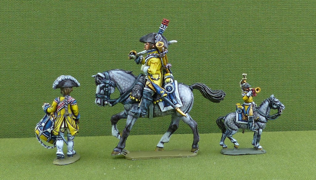

von Winterfeldt17 Sep 2018 4:19 a.m. PST
paint a fairly light grey – then add to those patches where you like the dabble – a heavy wash or artist water colours of charcoal black, dabble with white water colour from a tube.
