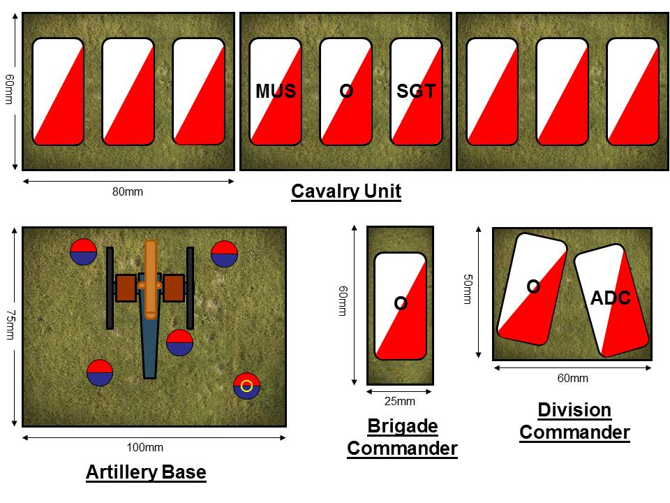

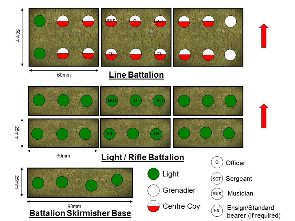

I base like this for 28mm figures on 2mm MDF bases:
British Infantry
Artillery, Cavalry & Command
French Infantry
