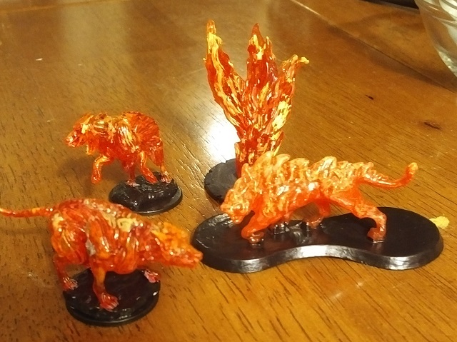

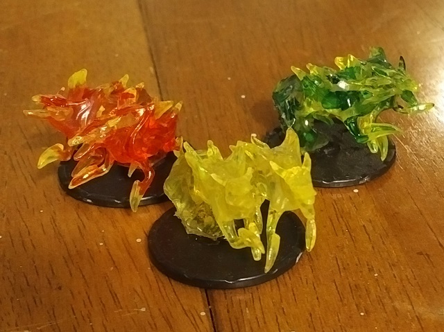

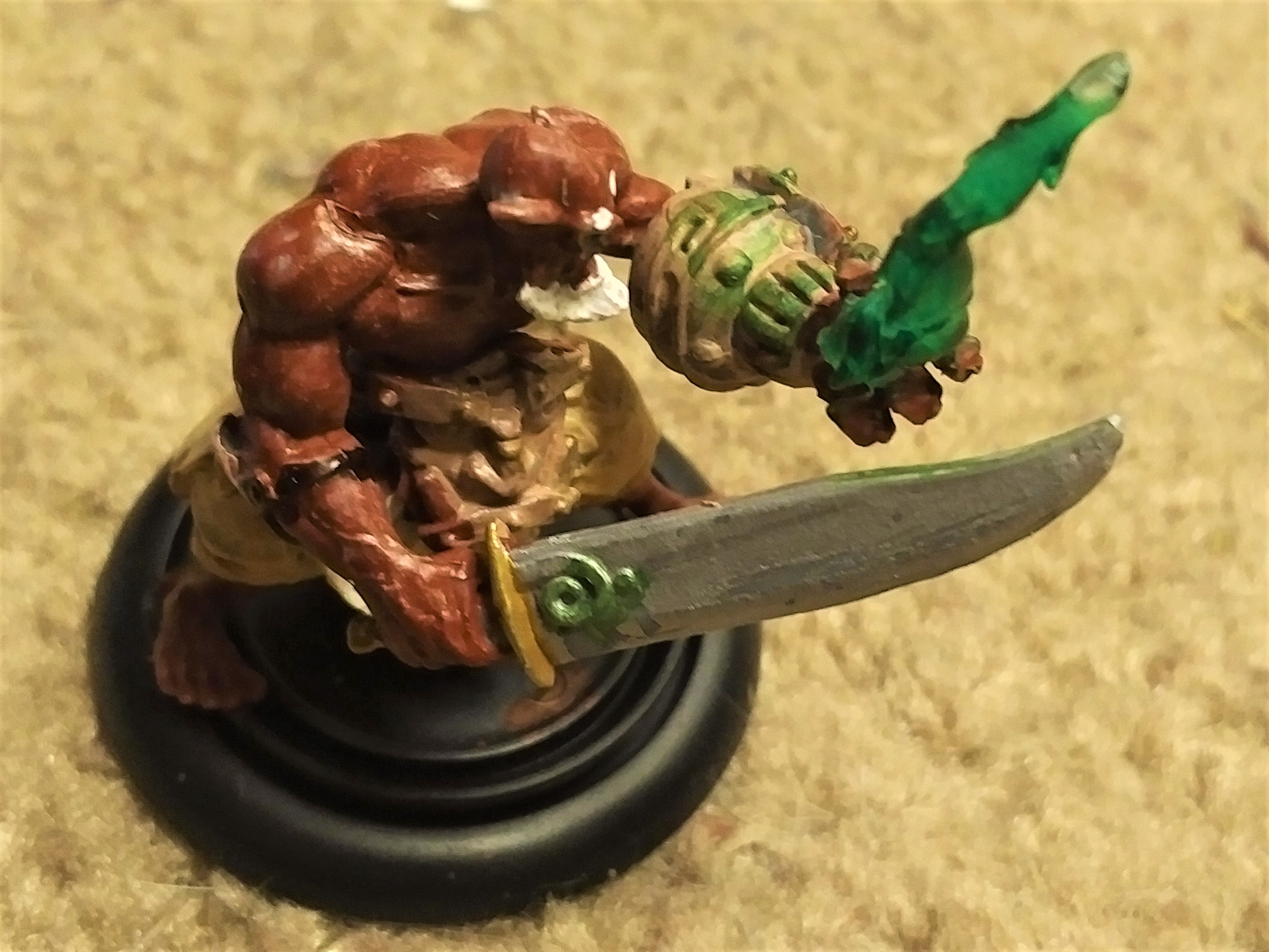

Personal logo etotheipi Sponsoring Member of TMP11 May 2018 1:11 p.m. PST
Highlighter ink.
You can use the highlighter to stain the surface with the ink or you can run a very soft bristle brush over the tip, then on the mini, depending on the coverage and effect you want.
This oni has green glow on the rune on the sword and on his hand to simulate light from the green flame. Done with green highlighter.

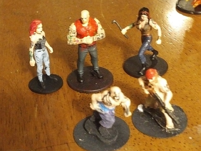

Personal logo etotheipi Sponsoring Member of TMP12 May 2018 7:22 a.m. PST
(Non-)Sharpies will work on acrylic paint (they're ink application devices, after all), but they have a lot more "color coverage" than highlighters.
Pastel or light colours will work over clear plastics OK. More vibrant colours may have a different effect.
I mostly use regular ink pens to color change metallic paint or with ultrafine tips to put tattoos on flesh.
