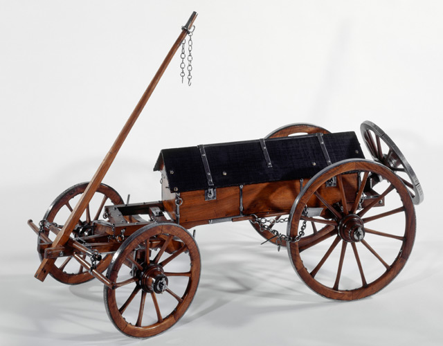

--- The French accomplished infantry ammunition re-supply through their artillery companies. Each artillery company had 3-4 caissons (4-wheeled, 4 horses) of infantry ammuntion, each with about 16,000 rounds. The infantrymen were supposed to draw their re-supply from the nearest artillery company attached to their divison. Taking Compans' 5e division of Davout's 1er corps in 1812 as an example, and assuming a full 4 caissons of infantry ammunition per each of the division's two artillery companies, that is only 128,000 rounds for 22 battalions, or 969 rounds per infantry company. It is not a surprise perhaps that just before the campaign, each battalion was ordred to receive a dedicated ammunition caisson, thus adding another 2,666 rounds per company. The revised total would thus be 3635 rounds per company, or about 30 rounds per man.

The French ammunition resupply system for both infantry and artillery ammunition moved the ammunition forward to the units so that both infantry and artillery units would not withdraw in order to replenish their expended ammunition.
The French foot artillery companies assigned to an infantry division had four additional ammunition caissons that carried infantry cartridges. Horse artillery companies were not assigned to this duty.
6-, 8-, and 12-pounder caissons carried 16,335 musket rounds. 4-pounder caissons carried 13,935 rounds. All of these caissons also carried 1,500 flints.
French infantry carried 35 rounds in their cartridge boxes plus a spare package of 15 rounds in their packs.
There was also more infantry ammunition in the division parcs, corps parcs, and the forward depots-50, 50, and 100 rounds per man respectively.
At Eylau's ending in the dark and cold, the ammunition caissons of Davout's III Corps moved forward to the infantry units to replenish their ammunition.

I have often thought….these were varnished wooden wagons, which carried thousands and thousands of paper cylinders, each one then containing gunpowder, whose sole function was to explode with a flash, at the slightest suggestion of an ignition.
I can see a nice diorama of a driver, smoking his pipe, whilst his colleague is opening the lid, for access to the ammo. There are 1815 tales of what could happen if one spark entered, let alone a cannonball or shell strike.

It is more deflagration than actually detonation or exploding with the old gunpowders, or so I have been told. I think that absent a confined space to build up a gas pressure wave, the stuff more or less just burns. However, even if the culprits might get away without major injury, cooking off 10,000+ cartridges due to sloppy smoking would be a rather serious matter.
Your cannonball (roundshot) was just solid metal. Maybe a spark against an iron piece of caission could lead to lighting the powder, but the ball hitting the caisson would surely send some nasty spllnters flying. A shell round was supposed to go off above ground, with some damage possible from shards of its metal exterior. But mostly it was intended to cause casualties by its concussive effect. However, were it to land on or by the caisson with its fuze still sputtering ….

--- the French guards would use 6 horses per caisson (3 pairs), not 4
--- for the caissons of infantry ammunition attached to artillery companies, the French mounted a conducteur from the train d'artillerie on each pair of horses, on the left-hand horse of each pair
--- for the caisson of infantry ammunition attached to an infantry battalion (administratively part of the compagnie d'artillrie régimentaire), the conducteurs were supposed to come from the train d'équipages militaires (3 men per caisson at full establishment, from 1811, but I would think 2 men per caisson was more common in practise).
--- for the caisson of infantry ammunition of a Russian infantry (or grenadier or jäger) company, the conductor (mounted on the left-most of 3 horses) was a "Фурлейтъ" / "Furleyt", a non-combattant of soldier rank with gray uniform
