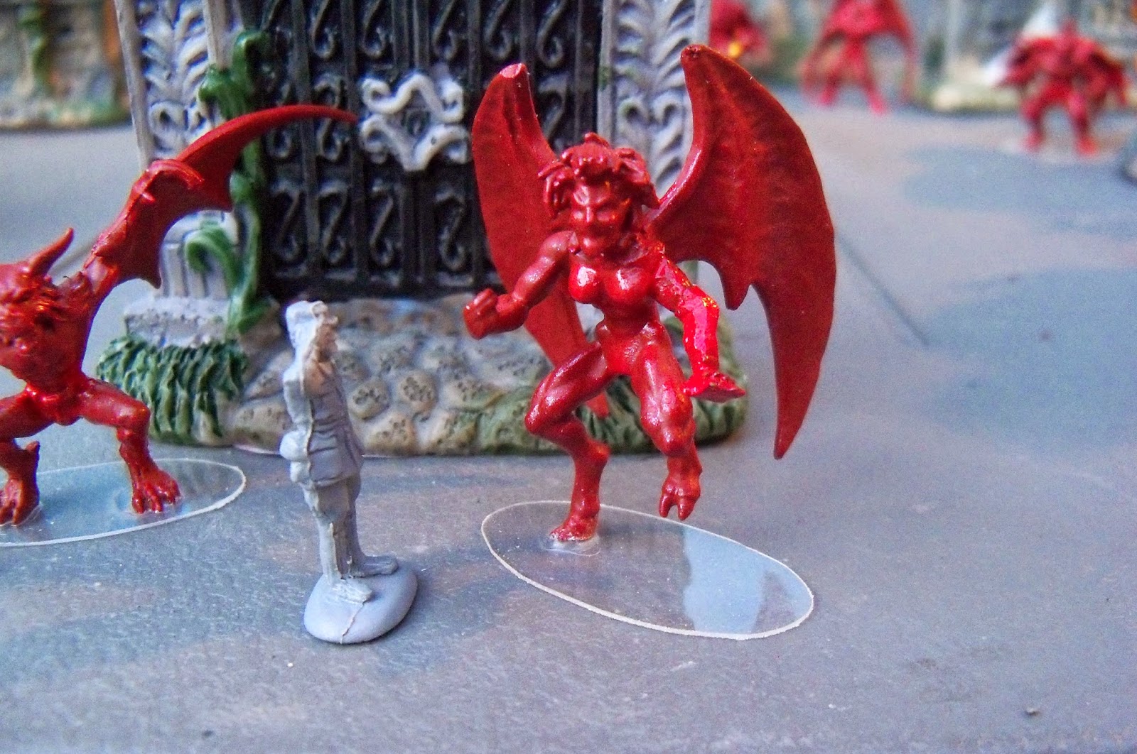

I am doing some conversions on Heroclix figures. New head, new wings, new base that sort of thing. Bases will be made out of sheet styrene and I usually use a mixture of CA and regular model glue. Put the CA on the Heroclix figure and the model glue on the sheet plastic wait a few seconds and then put them together, seems to work.
I have been using CA to bond Heroclix parts to Heroclix parts but I was thinking there must be a better way. What you do use for this process?
My first group was demons, my new group is angels.
