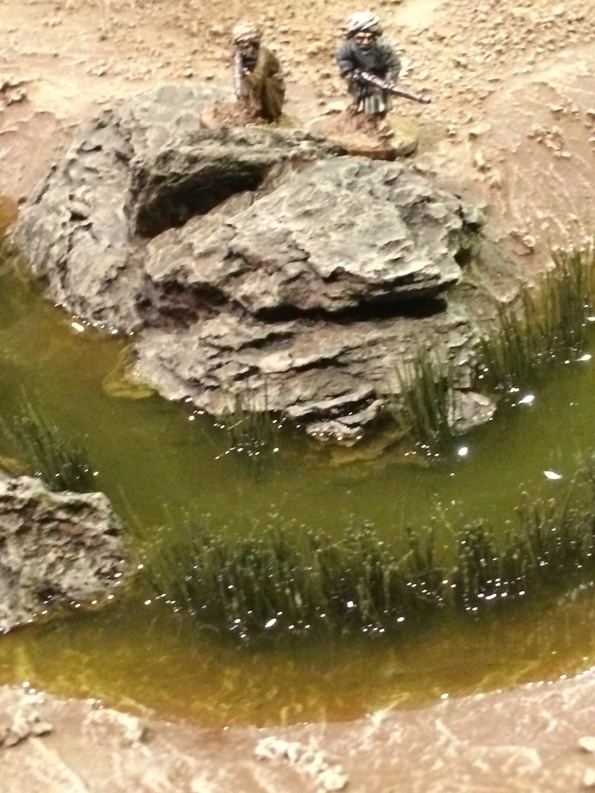

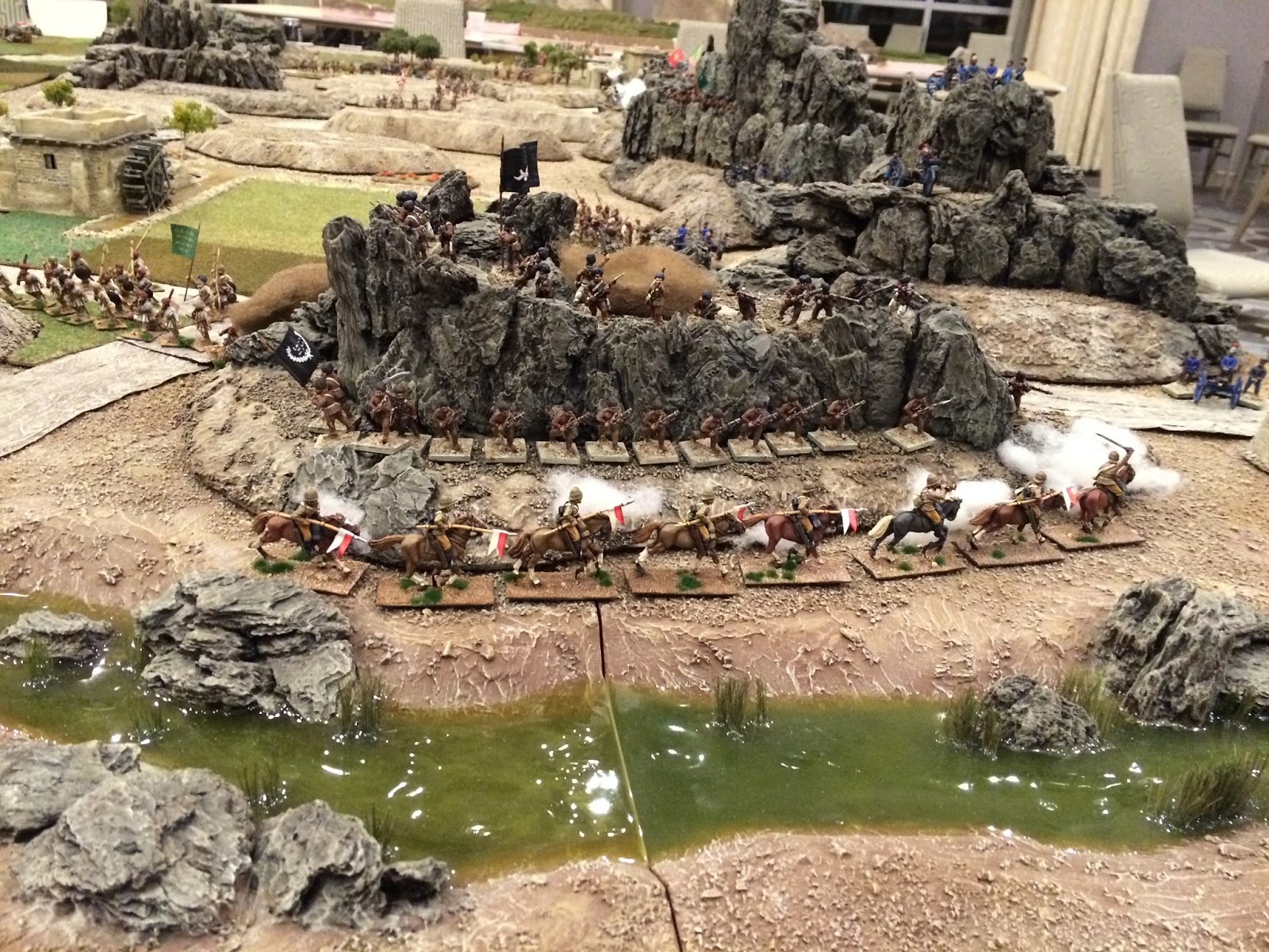

Here are a few sample pics of a couple of my river boards. The lighting makes the color of the water look a bit more garishly green than in real life, but I think you get a sense of the wavy "flowing" surface.

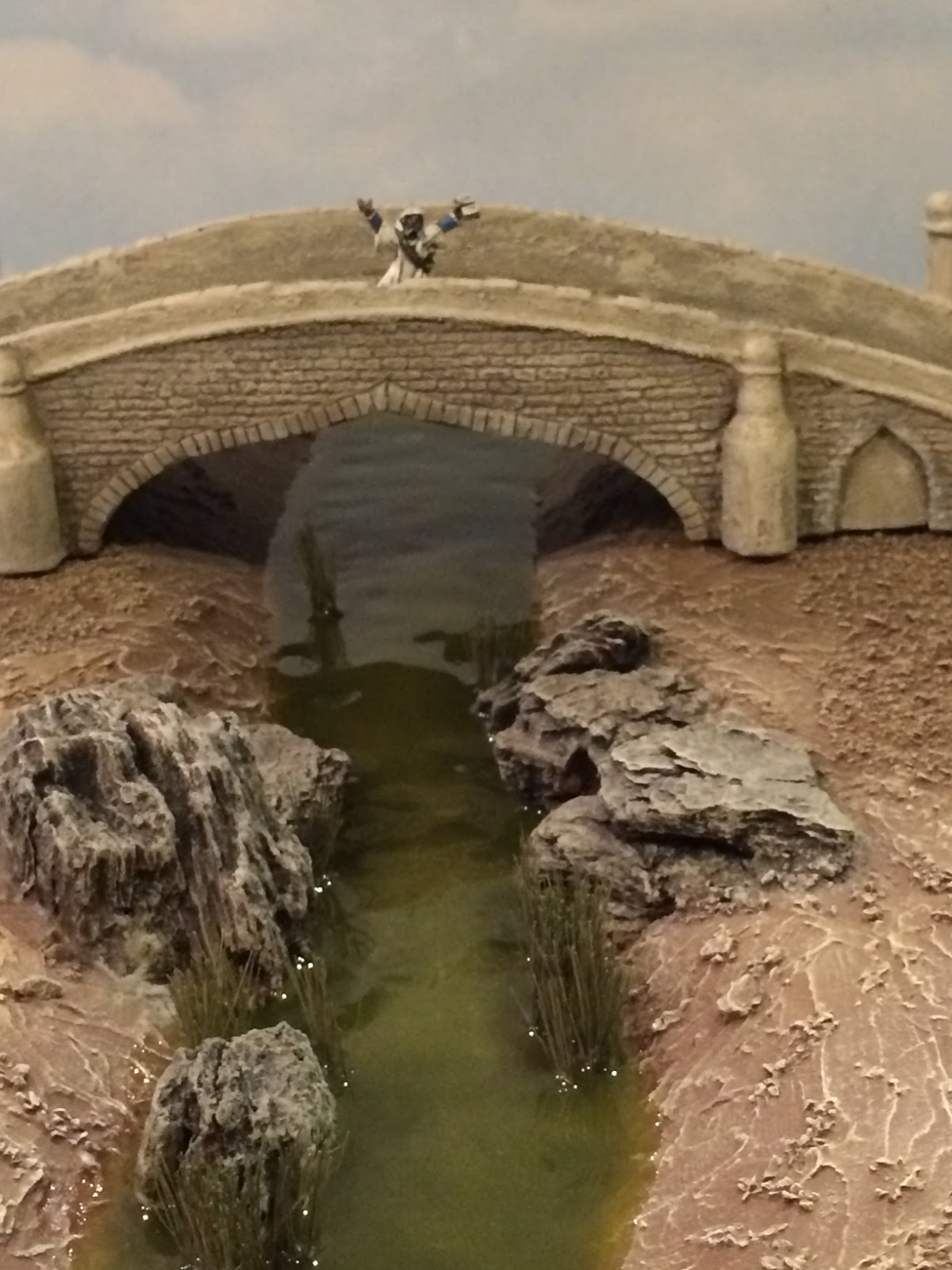

Here's another view with the river in the background…
Some people (including myself) like the "glassy" effect of resin water features, as well as the sense of depth multiple pours can bring… but whether or not they're worth the tremendous amount of time and effort required when compared to other methods is a subjective question each terrain maker must answer for themselves.
