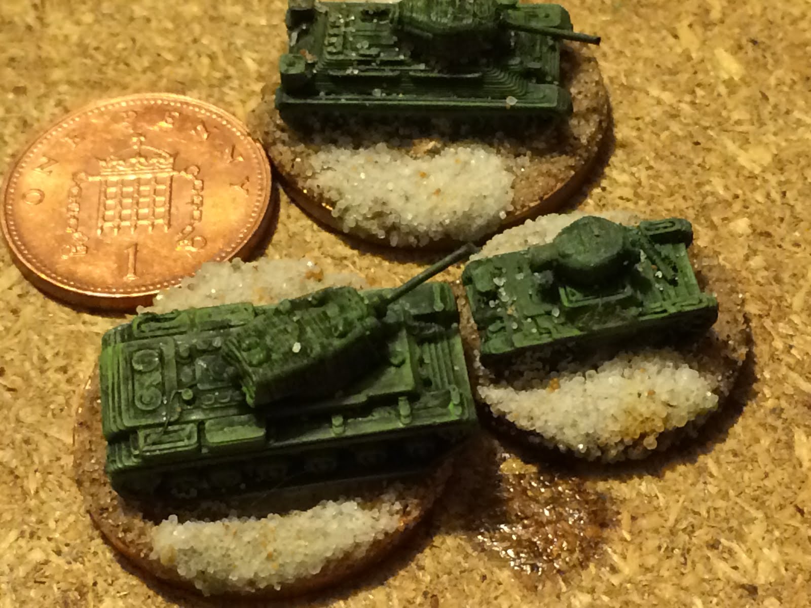

suntzu77731 Jan 2018 2:51 p.m. PST
i have no problem makeing tanks in 1/285 here is a link to a picture on my blog , the printer is a cheap pla only model
The H Man Supporting Member of TMP31 Jan 2018 9:40 p.m. PST
You can still see the layering, especially on top of the hull of the top one. Otherwise for armor, ok, at a pinch, but what about people? Anyone have some pictures? Would be worth a look.
suntzu77701 Feb 2018 1:25 a.m. PST
agreed , but with my eyes i have trouble seeing the tanks , the phone camera has much better "eyes"

UshCha Supporting Member of TMP01 Feb 2018 10:02 a.m. PST
H Man, the picture shows the model probably 8 times bigger t g an the real thing. At wargames distance it would be perfect.

Sun turned, which printer did you use excelent models.
suntzu77701 Feb 2018 1:30 p.m. PST
You can see other images and printer info on my blog
Wanhao Duplicator I3 Mini is the printer i use
