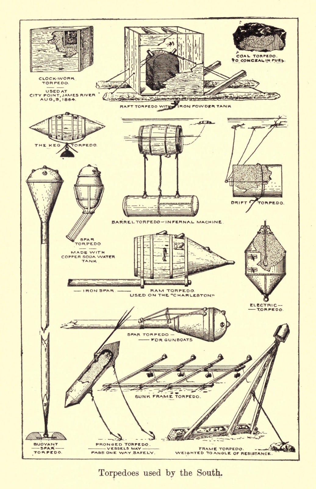

I do not think they were fire ships at all, but more like "drift torpedoes" "drift torpedoes" used by the south in the US Civil War : a box of balls filled with powder attached to a long pole arranged so as to ingite the powder if the pole touched something. I think the Austrian land army might have lacked the experience of manning and operating proper fire ships such as would have be used by the Royal Navy or French Navy. It would be a tricky job, as your crew, after jumping off, would be swept downstream into the fires set. So you would need to get them off onto boats or ships.
