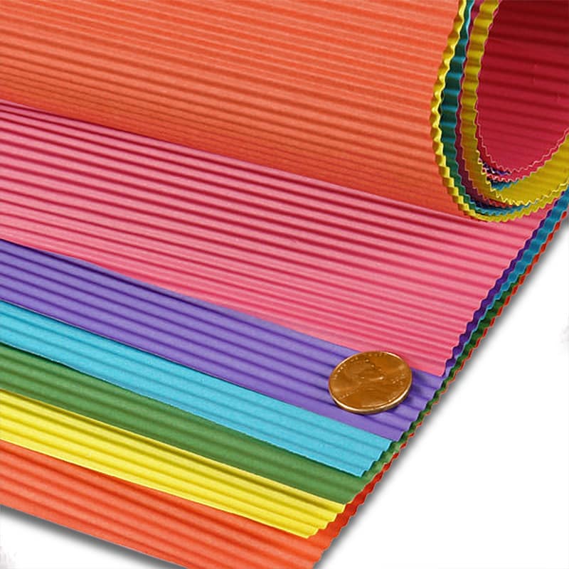

Cacique Caribe03 Jan 2018 7:28 a.m. PST
Or find a place that sells something like this in smaller amounts:
Dan
PS. No backing layer at all, on either side:
Cacique Caribe03 Jan 2018 7:39 a.m. PST
I guess that, as with anything else, the corrugated paper industry has its own lingo.
"E-Flute, (1/16") single face" corrugated paper looks perfect for 15mm.
Dan
