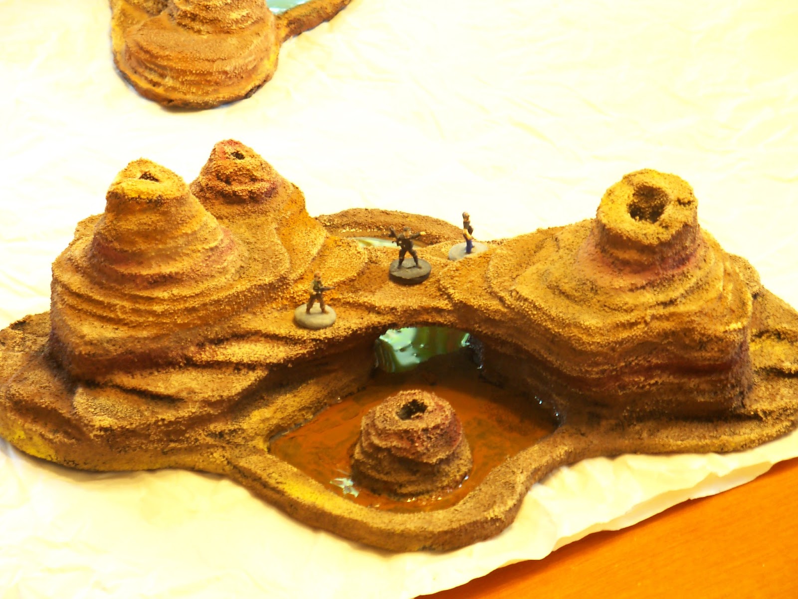

So let us start with the new stuff Okay so surfing through on Google Plus and came across a great idea so I had to try it.
Elmer's Clear Washable Glue!
For Water Effects!
Looks great yeah! So no mixing or smells of resin for small jobs just a little of this and DONE!
Next is a new addition to "My Terrain" Project.
"Volcanic Steam Vents and Bubbling Mud Pool"
So if you have been following this you can see more pictures here link
Doug
silo1313.blogspot.com

I personally mix Vallejo water effects / Gloss Varnish & White wood glue to good effect.It can easily be dyed with inks for murky water also.
Years ago I found something similar to yours at the stationers ,If I'm not mistaken it was a Japanese type paper glue. Haven't seen anything similar for ages , must look around.

Okay so be careful on how thick you pour this stuff it has been better then 24 hours and I'm still waiting for it to totally dry.
We kinda laid it on thick, about an eighth of an inch thick. (about 3mm)
So I'll keep everyone updated.

War Monkey22 Sep 2017 2:33 p.m. PST
48 hours have passed now, the outer edges are dry now and the inner sections are lightly tacky in the middle enough that one could leave finger prints.
It also dried much thinner then I thought it would have, much thinner, this leaves room for adding more layers where one can add color to the layers or thin paint as well and get a deeper looking effect.
Just remember we did put this on very thick which I think effects very much the dry time, I'm sure if I had put it on like you should have it would have dried in minutes. Lessons learned.

War Monkey23 Sep 2017 8:41 p.m. PST
Alright! 72 hours and it is finally dry!!
Wow did it shrink as well, like I had mentioned we put this stuff on rather thick like 1/8 inch (3mm) thick and it dried to less the a millimeter thick.
So everything that I thought would stay under the surface is now poking through the surface a lot.
Okay I can touch and poke at it and no finger prints it's really smooth to the touch and not tacky at all at the moment we have the AC on so brings the humidity down, no matter I will just coat it with water base polycrylic and be done with it.
So we will do another application and see what happens with it and we will keep moving o from there and I will continue posting g the results.

War Monkey18 Jun 2018 6:35 a.m. PST
Okay so a quick update, it's be very hot and humid here and I'm glad to report that the glue stayed hard and smooth I didn't feel it being tacky at all so I will be adding more to this piece to give it more depth.

War Monkey18 Jun 2018 8:54 p.m. PST
Thanks CC, I need to paint layer, paint layer to build it up some I'm hoping to give it some depth.
