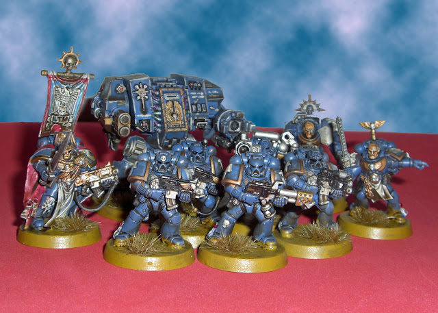

Based on the short Youtube video from Lukes Affordable Painting Service (APS), I was curious to see how quickly I could "paint up" Ultramarines from the Battle for Vedros Starter Set using only Sharpies.
I first primed the Space Marines with The Army Painter's Ultramarine Blue. I then proceeded to "paint" the miniatures via Sharpie pens, afterwards dipping the models. Unfortunately, the dipping media did dissolve some of the pen marks, so I had to reapply after dipping. The colors white and red were a pain. For red, I first had to color the spot white, then add the red afterwards. I also had to use flesh paint for the faces (Sharpie doesn't make a flesh-color pen).
More lessons learned and photos on my blog….

Well for sharpie pens as the medium they look pretty good and clean. Reading your blog post however it seems that time was not really saved. Kudos for the experimentation and you did achieve a good effect.

Mezmaron08 Sep 2017 12:18 p.m. PST
Overall, not as much saved as I would have liked, or was expecting. The metallic pens will be my primary method going forward for metallic colors however.
The key time savings is how easy setup is. Have 2 minutes of spare time? All you need is the pen and the model. No clean-up, etc.

Perhaps it would be worth trying craft store paint pens which are cheaper than sharpies and come in a wider variety of colors? My dip of minwax polyshades didn't seem to affect the silver paint pen. Alternatively a spray of varnish over the markers before the dip might help preserve things.

I think the problem I had with the Minwax Polyshade was that I used a brush to distribute blobs after dipping the model in the media. The brush movement over the metallic faded it and I had to reapply after dipping.
Had I just dipped it would have been okay….

The last few steps were to dip the model, apply the decals, glue in the drive and gunner, re-apply dipping media over the decals. I finally applied a matte spray to tone down the reflection of the dipping media to complete the model. There are a few touch-ups needed to be made with a fine Sharpie pen, (in areas where I still see some blue where it shouldn't be).
As a proof of concept, it was a success. The metallic Sharpie pens worked great and saved a ton of time painting those colors.
